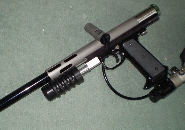

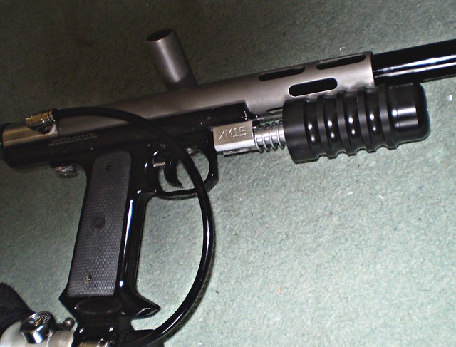

Pictures now uploaded. Forgot how chunky a stainless MiniMag body and level 7 valve is. Definately not one of my lightest pumps so far, but a ULE body and X-valve from my EgoMag should put it on a crash diet. Still needs some tuning - bolt leaks between shots but seals when cocked. Been advised I need to add spacers to the powertube o-ring. Pump stroke's is less than 20mm :)
