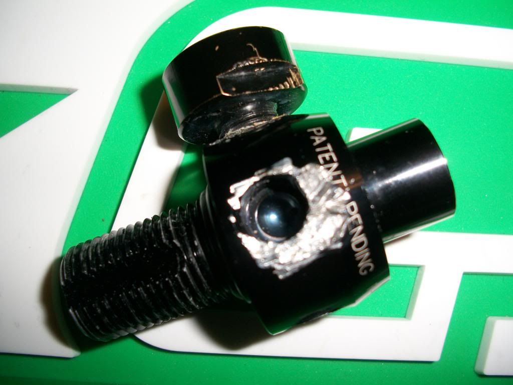

tried it still on and now snapped my strap wrench also im now thinking new wrench and a vice for the reg just need it off now lol

Finally got it off hot water didnt work so vice strap wrench and a lot of swearing later its off bin fodder but at least i can get a new reg on it now lol
