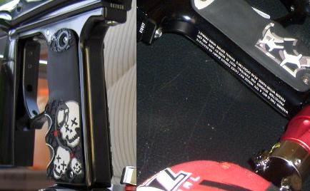

Even older Minis don't have "the warning text" engraved on the rear of the gripframe.

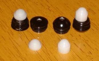

There are 2 (two) styles of detents
V1 detents (left in the picture) tends to stuck inside the cover and strip the threads or allen holes, because the detents where to short and the cover to flat.
V2 detents have a rounder cover and longer detent.

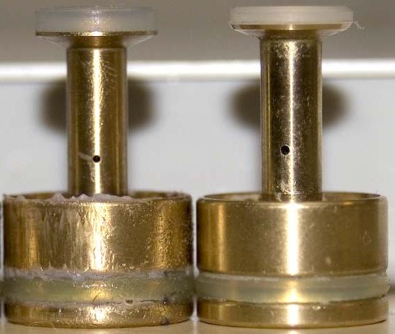

There are 2 1/2 (two and a half) poppet types.
De-gas your marker and pull the boltguide out. Screw the backcap out of the boltguide and use an allenkey to push the poppet out of the back of the boltguide.
Inspect you poppet.
The one on the
left is the old poppet with the smaller hole. Also notice the diff. in the front seal.
The spring poppet isn't exactly a third gen. poppet. It's a second gen. poppet with a spring and a larger hole (5mm, not 4,5mm) on its backside.
The advantage of the spring poppet is, that it resets itself and saves a picayune amount of air, thus increasing efficiency.
