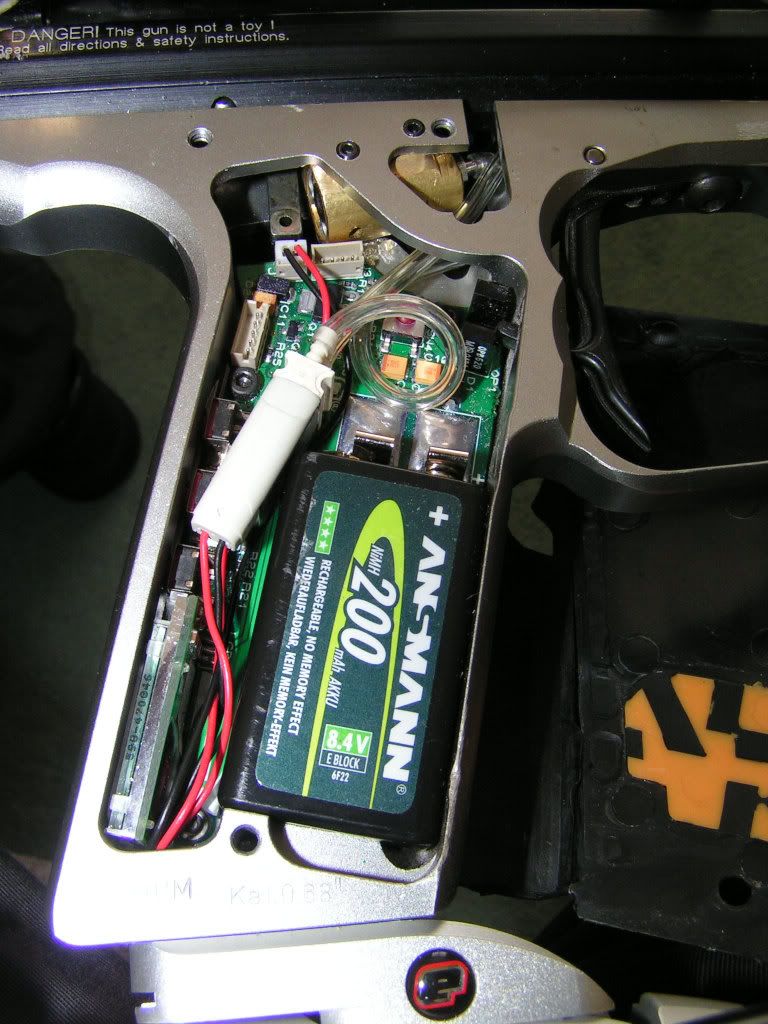

You can see the clippard MPA-3 installed in front of the sear on my EgoMag here...
wow dude thats a lot going on in there,, but very clever,, im trying to go the other way,,, sort of less is more,,,
