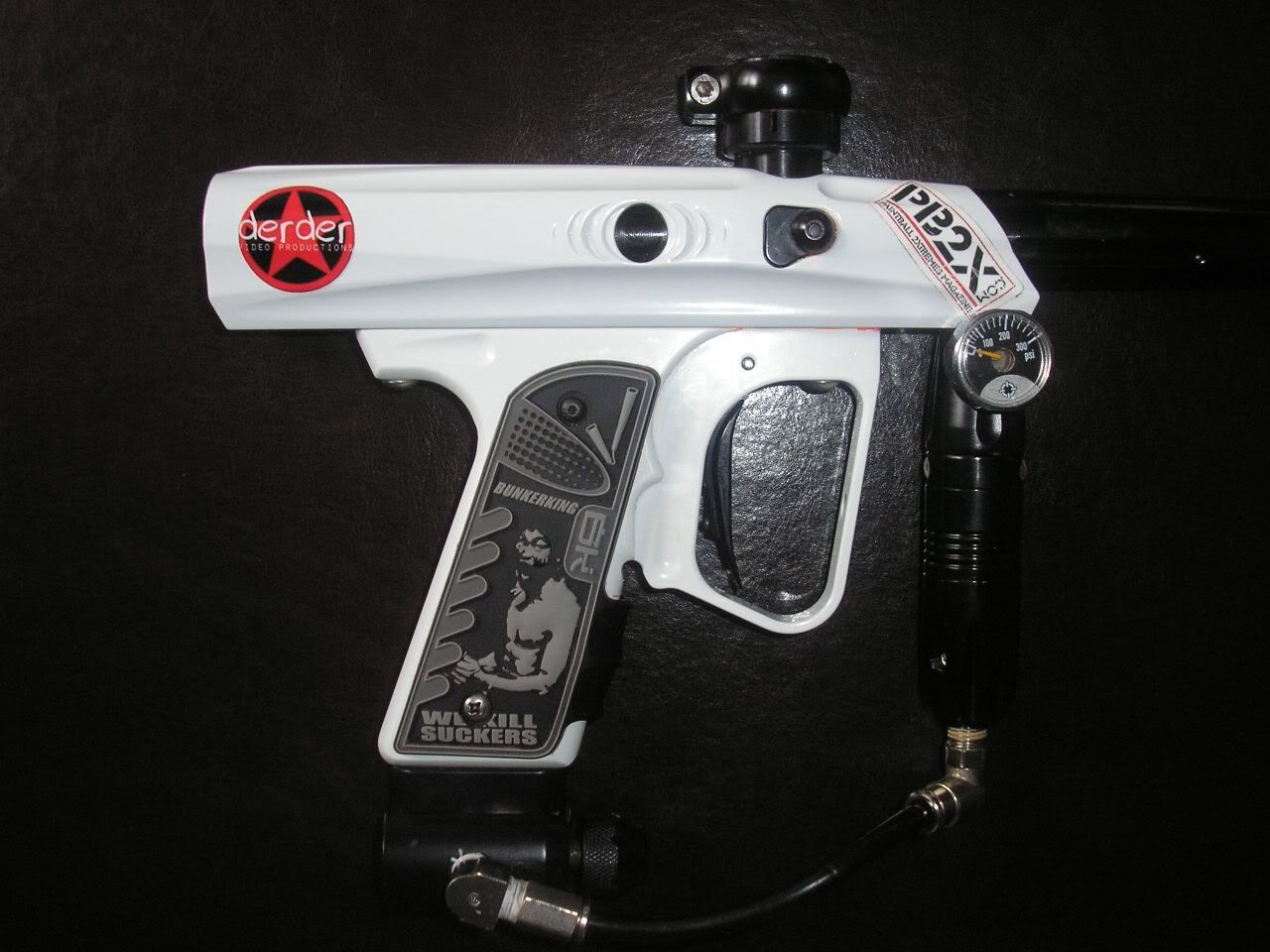

sutton said:
Im pretty sure that is white except it is powder coated instead of annodised. This means it is just a surface coating. Correct me if i'm wrong
you are correct its a very ****ty surface finish very cheap and cheerful could screw up the internals if it doesnt get removed from the inside:D
-si-
Shades
Live Life
Aug 9, 2005
282
Midlands
You are correct you cannot do white anodising the closest you can get is magnesium but this is vey very expensive and specialised. The ones you are looking at are a very light silver, but come out very good giving you the closest to white you can.
You can powder coat some markers or parts white, also you can chrome plate markers to. Looking at doing a Speed06 at the moment in chrome.
MattL
Jan 21, 2005
46
You are all quite correct, the white is a specially brightened, dusted finish that approaches white. The difference is, no dye is actualy used. Whatever colour you fancy calling it, the results are pretty impressive. We will be putting up a gallery soon of some of the jobs we have done.
