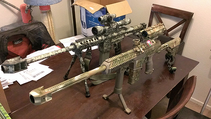

A little about me. My name is Robotech and one of you folks posted my WS-66 tear down guide up above (thank you...). Up until this year I shot a WS-66 as my primary marker.
![](/proxy.php?image=http%3A%2F%2Fwww.b17queenofthesky.com%2Fpaintball%2Fws66new%2Facu%2Fbarretacu-02.jpg&hash=f43dea4433f18443ed99b2b1fa689b48)

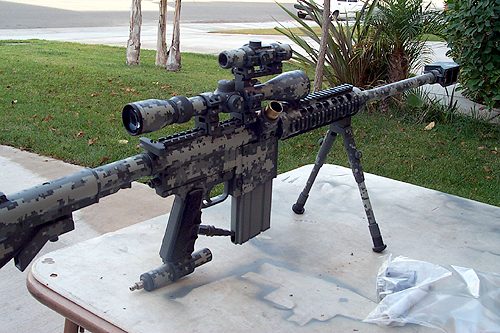

She just got replaced by a Dye DAM.
![](/proxy.php?image=http%3A%2F%2Fwww.b17queenofthesky.com%2Fpaintball%2Farsenal%2Fbarretts_001.jpg&hash=55abae0b118e74acd74fc83b644e6139)
I've had the WS since I bought it new in 2004 and have owned a couple more in the years between now and then. (Wish I hadn't sold them.) They are great markers and the Hop-Up barrel they come with is superior, in my opinion, to the Tippmann Flatline and the Apex barrels when it comes to putting a backspin on the ball. It does work and work well. If you can find one, and don't have it already, I highly suggest picking up a Delrin bolt for this marker, polishing the internals and the striker, and cleaning then waxing the barrel. Does wonders. Also, since you have to run CO2, if you go with a remote line setup you're better off than going right into the ASA. If you can, add a Palmer Stabilizer Regulator under the grip in place of the ASA and add a second one on the CO2 remote valve. Set the first one to 800 and then dial in the second around 500-600. With these modifications my WS will shoot 285 over the chrono plus or minus 2 fps.
