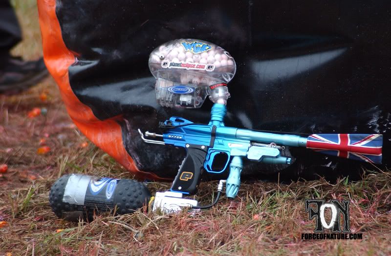

Milling is same on both, colour is a darker blue to light silvery blue not light blue to silver. Colour match on frame to body is perfect so presume E2 is genuine.

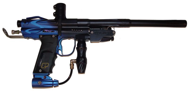

E1 dc1 in this pic it is non samuri triger
E1 dc2 " THIS IS NOT AN E2!" has got samuri trigger tho
And then what you should have budgie E2 dc2
the easyest way to tell them apart ( the frames that is) is by the location of the trigger pin e1 and e2 frames are different here. The sealed soloniod cover could be easy to change but the bolt pin is not.
hope this helps budgie sorry if pics are dire but off the web!
not sure about the inclusion of the intergrated bevertail but you will definatley be able to tell from the pins
