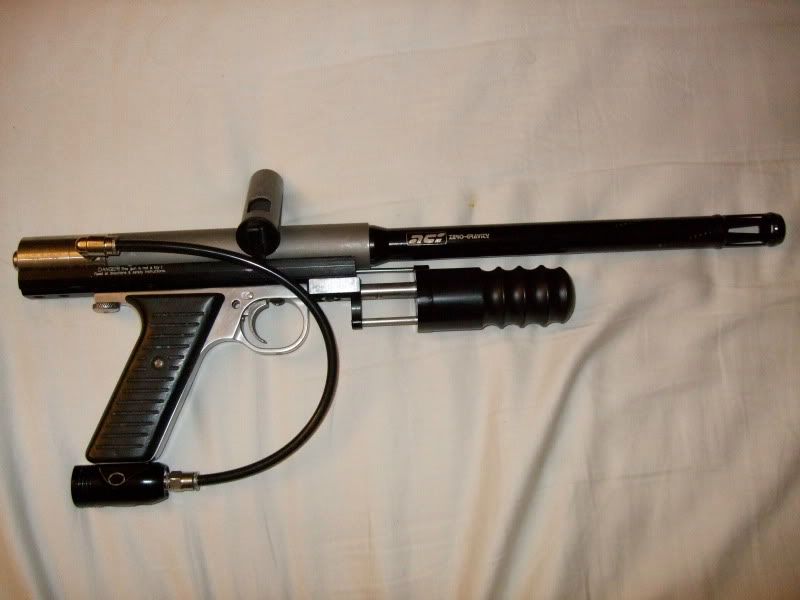

Hello Renie
Pneumag is looking very good.
Have you ever tried a Pump mag at all?

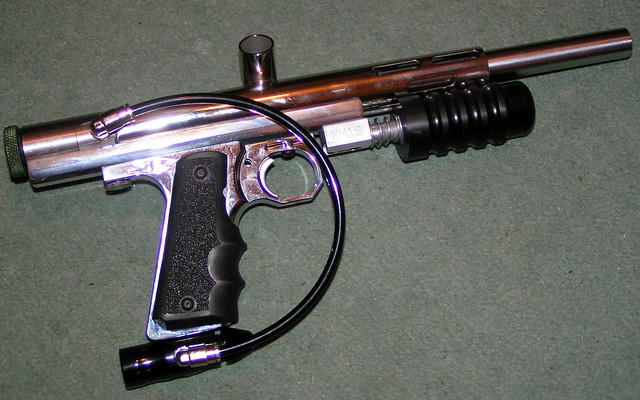

i haven't mate, Gee Tee has one, actually ive milled a rail for him but thats as far as ive stepped on those

I am still think about the etekmag, but I am thinking about a pumpmag.

It's a pretty simple conversion once you have either bought or made a pump kit. Rail and body needs to be milled, wave spring fitted behind bolt and finally power tube spacer adjusted to seal o-ring. I've built two pumpmags from parts so far using XM15 kits.
