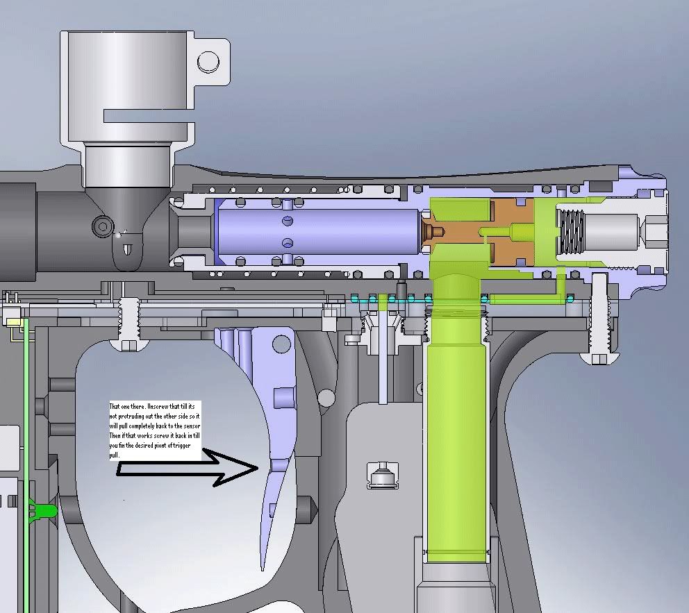

ok one of my team been playing about with his mini and now it wont work .
when you turn it on red light stay on and green light flash . iv'e tryed 3 new batterys ,
i think he's played about with the trigger by the look of it ..
help any ideas what wrong with it.

try the bottom trigger screw it sounds like its not engaging the sensor wind it out a fair bit so the tigger pulls all the way back and see if that makes a difference. it should then register i had this problem at one point.
hope this helps
