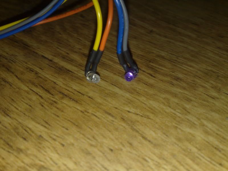

here's a pic of the eyes too, are they supposed to be different colours?!
i reassembled the unit how it was given to me, and taped the cabling in the same places so i literelly just cleaned it when i took it apart/

I had the same issue with mine, i had to buy a new set of eyes to solve the problem.
i got my set from lips.
how much is a new set of eyes?
are they supposed to be two different colours, the diodes i mean, like in the photo above?
