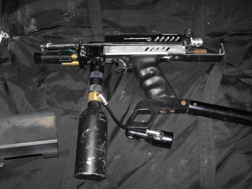

Have you noticed whats different with the mag?

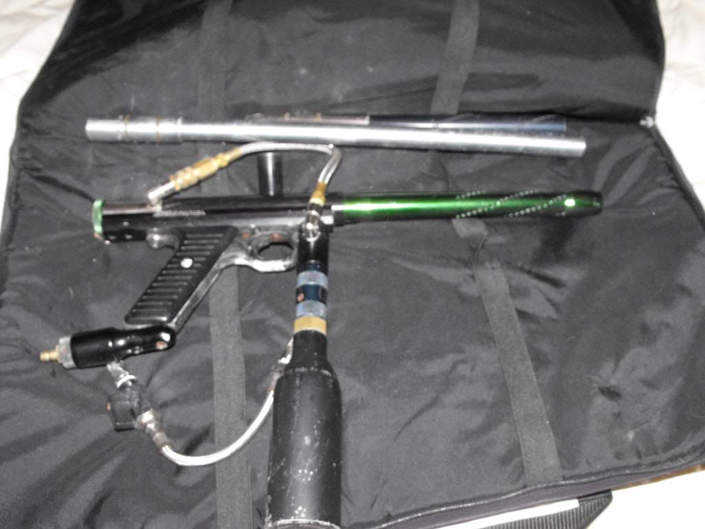

They are proper old skool markers (like the Sterling in the sales section, fantastic looking marker, wonder where mine is) and I like the weight of the cocker, with the 20oz on frame.

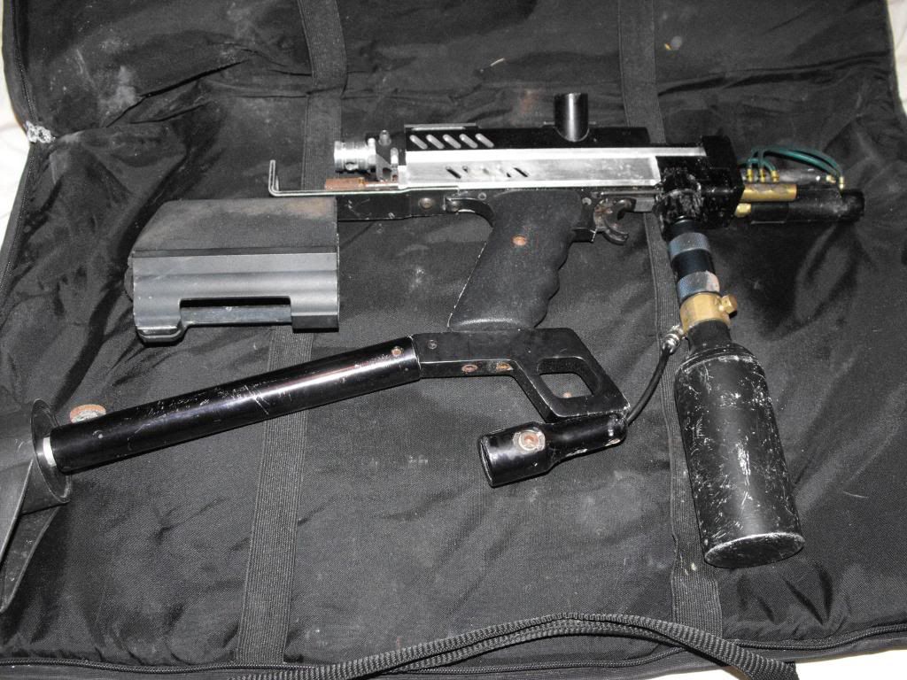

I cant tell anything different about the mag apart fom the black body and dac tulip barrel.
the mag wont take much to convert over to air just by pass the 3.5oz front bottle and run a line straight from the bottom line to the valve and it is done. The cocker on the other hand will require a regulator in the place of the 3.5oz bottle. Then it should be good to go. Obviously both would require a strip, clean and re lube.

The black body just shows its age.
And its not a common thing (at least it was special order when I got it), for the mag to have.
