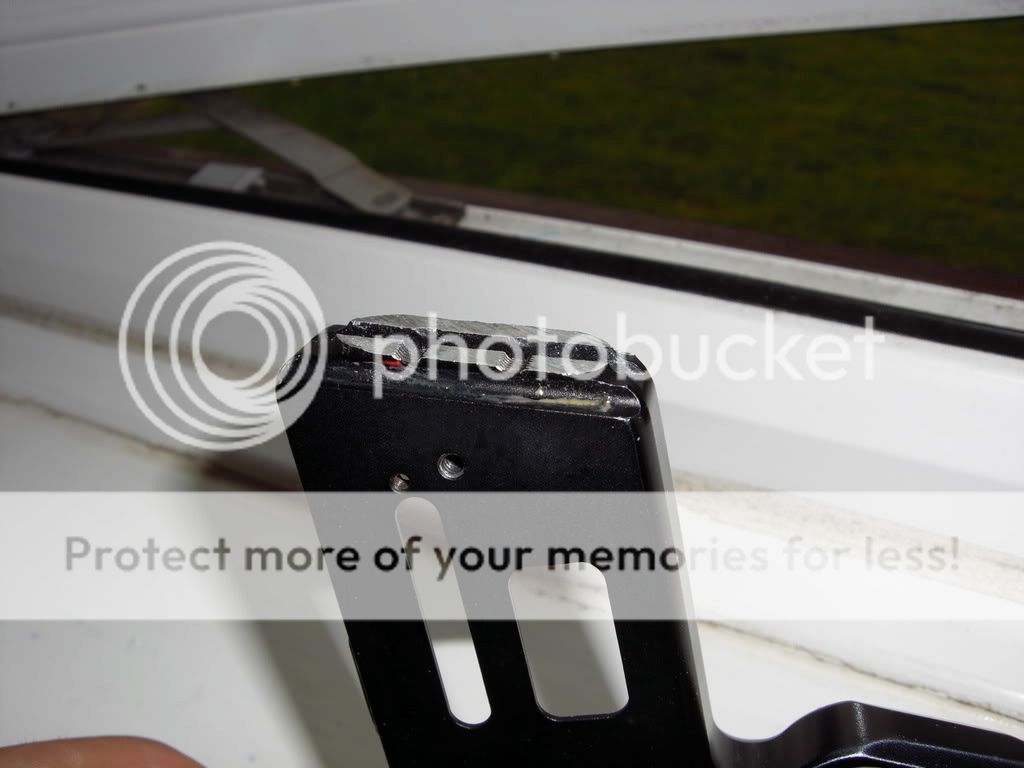

This is what was left of the slide rail after the hacksaw modification.

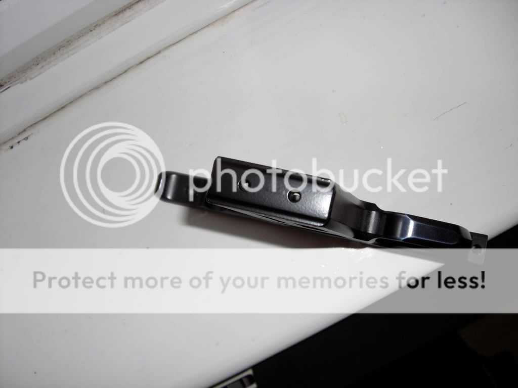

So i got to work with the file until a got it down to this.

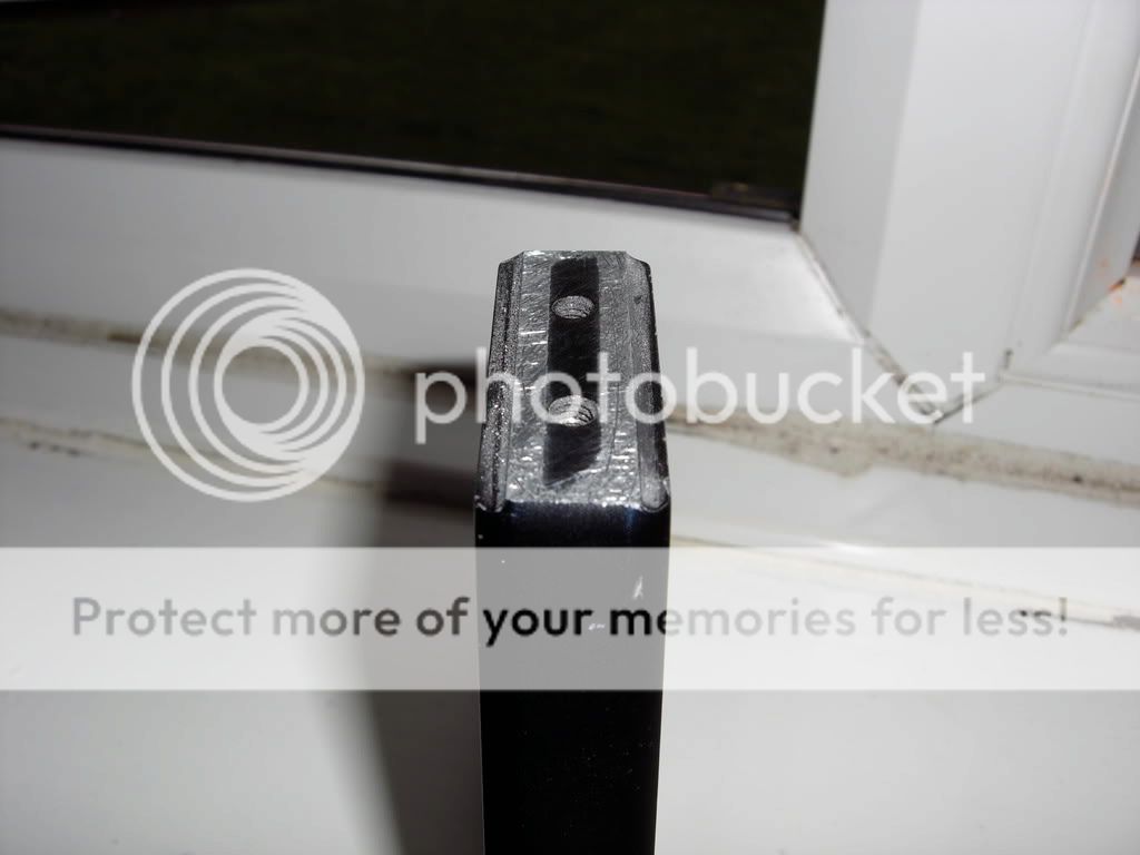

After i had got it to the above state with the file i got to work with the wet and dry starting with the course and working my way down to the fine until i had achieved this finish....

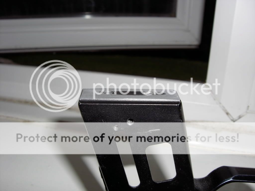

Then it was a simple case of some careful masking and a couple of light coats of satin black spray paint to get this finish.
Its not the most professional repair in the world, but i am happy with it and looks a damn site better than it did in the beginning.
