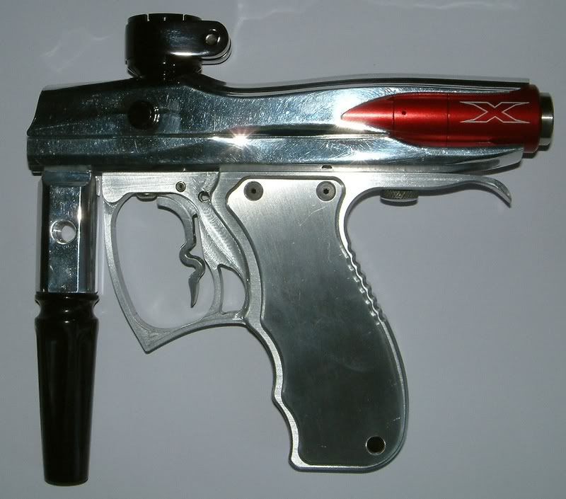

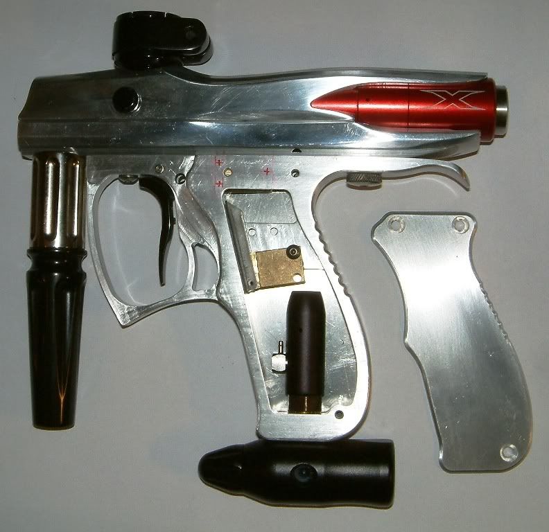

As it stand I own 1 X-Mag, 4 E-Mags, 1 Euro Style Mag, Karta Logic PnueMag, EgoMag and my latest project Dallara body on Cerberus AirWalk V2 frame I’m in the middle of PnueMaging this puppy. 16bps and no battery in sight.
My new toy, body and frame raw. thinking of sending it to ODD when I'm finished mounting the PnueMag internals.

In the photo below I’ve milled away the middle hump and swapped out the stock trigger. It’s pretty much the same as the one in bolters first photo. But with a modified V2 AirWalk frame
The one in the first pic Bolter put up works out as a pretty expensive bit of kit for a first gat. Most of those parts are going to be very hard to find and will set you back around $1000 US and that’s not including the valve.

Well it’s your basic mechanical platform you’ve got the X-Valve with ULT installed. Hopefully that and the L10 Bolt are nicely tuned. Now you can start to customise, body, rail, grip frame you can PnueMag it or you could whack on an Ego or E2 frame on it for a nice electro pneumatic marker. Seen it done with Ion, Spyder and DM frames as well.
Could even just get a set of E-Mag lowers and turn it in to an E-Mag but you’d need to change the on/off in the valve.
If you go down the E.P. or PenueMag road then you’ll need technical know how the equipment and you’ll need to source all the additional parts Tap, Dies and pneumatic parts.
Last year I bought a Milling machine and lathe so I could do all the work myself rather than ship my gear to the US for custom work.
You must remember the EuroMag is a mechanical marker, without extra work even an ION can out perform this masterpiece of engineering. Unless you buy an adjustable reg and pump 900-1100psi straight in to the gun.
On my mechanical Karta Mag the pressure gauge read just shy of 1100psi to work like Gassy's EuroMag.
Not entirely sure this would be an ideal first marker for a youngster When there are so many other gats ready to rock straight out of the box. It’s a labour of love.
