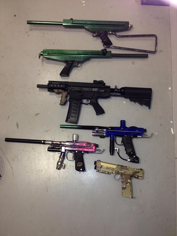

Todays photo call :)
2 x STP Golden eagles
TGR2 CQB
E2 Prostock with Evo internals
E1 Blackmagic mini with eclipse/evo internals
TiPX with FS block and dremmel work :)

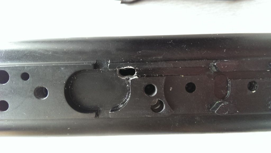

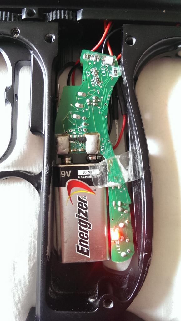

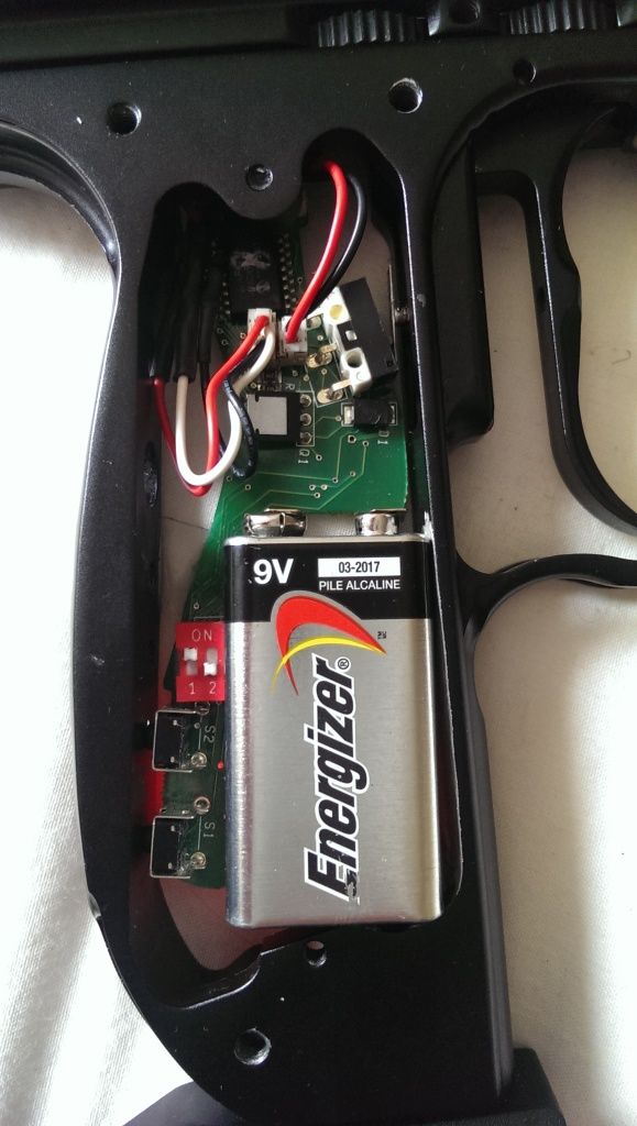

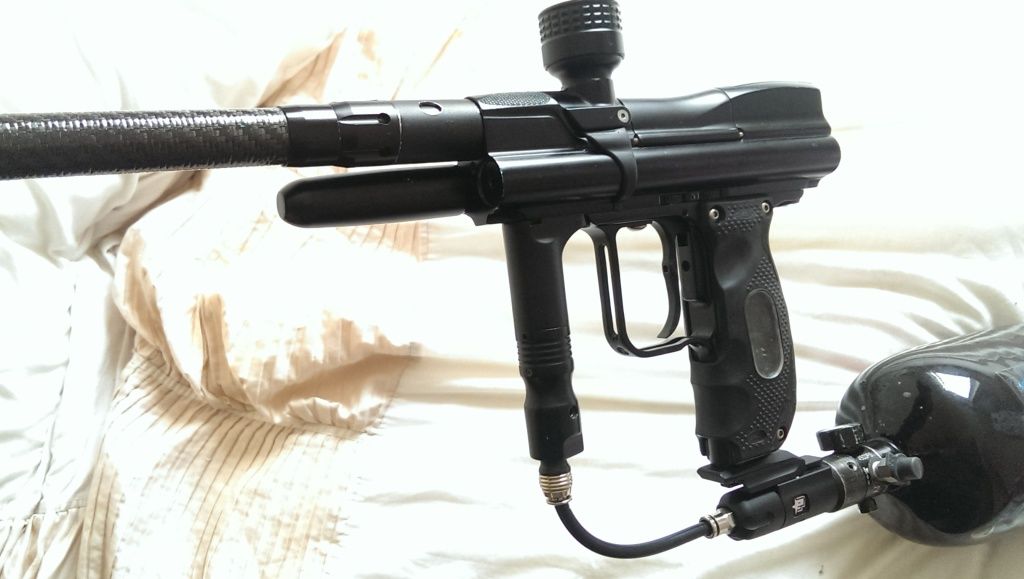

Just thought i'd show you what I did when I had a spare A4 Fly, DM12 board & some eyes doing nothing when boredom kicked-in.
Little bit of trimming to the top & bottom edges of the board so it fits;
small piece of plastic glued to the frames edge and to the board;

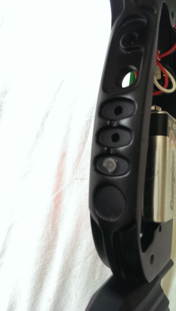

Trimmed down one of the clear frame buttons to use as the on/off

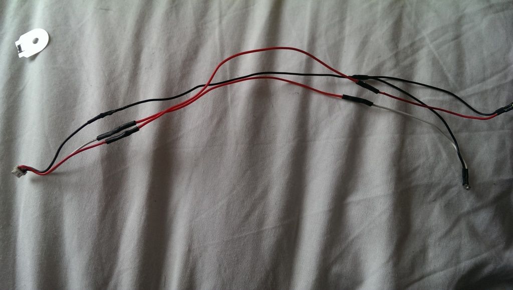

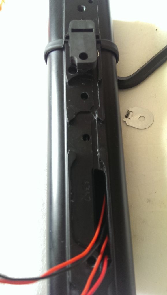

Extended the eye wires and bored out the bodies eye holes a little
Drilled hole into battery chamber to route the eye wires
Video of eyes working

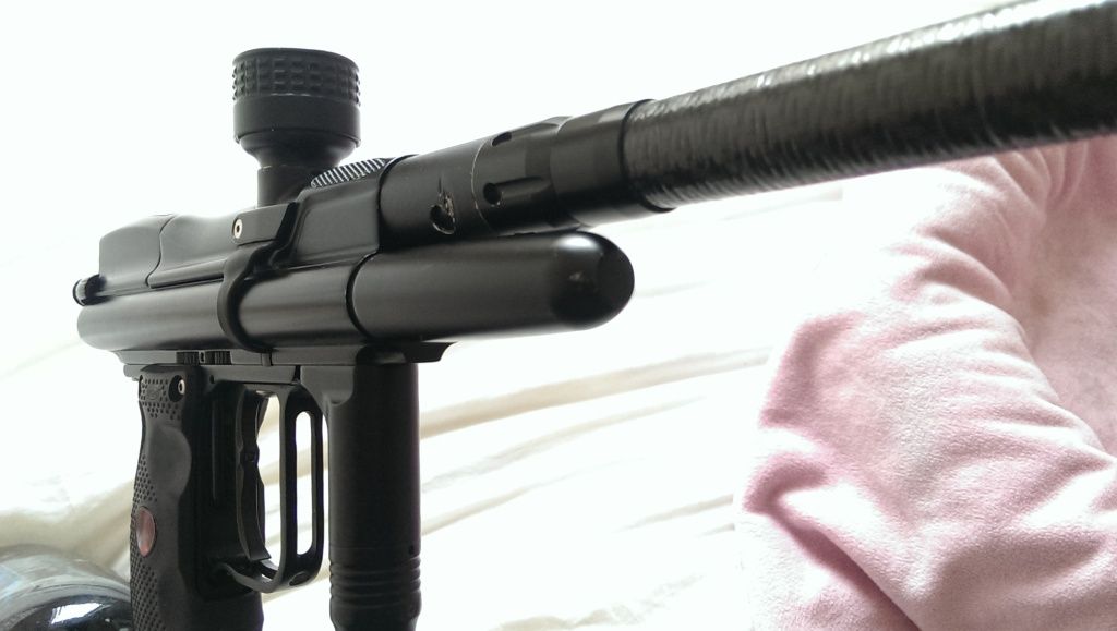

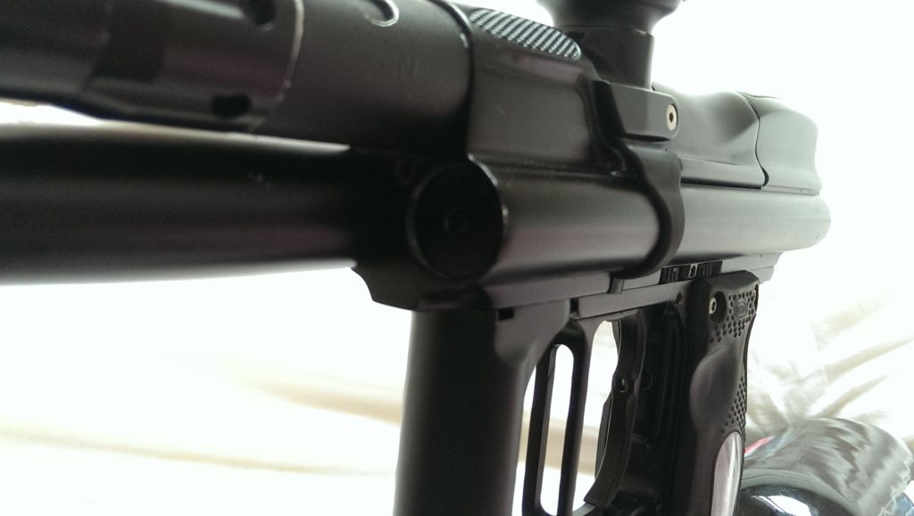

Finished item
Happy Days :)
