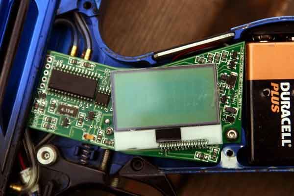

OK, first I'll admit that what I know about Timmys could be comfortably written in large print on a postage stamp.

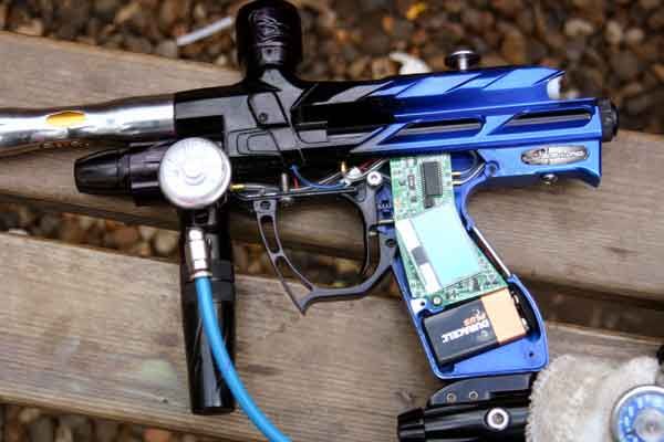

Team mate has this gun wot I believe is a 2k4 model of some description (tbh he doesn't seem to know too much about it either). It seems to shoot a bit wild :eek: we are convinced its the board settings, but want to make it tourney legal because we're fed up with lending him our shootas on the field :)
Close up of the board

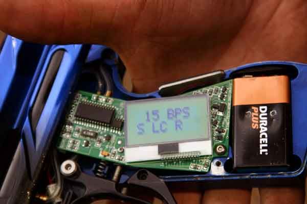

and the display
There is a rumour it may be a non standard board or something :confused:
If you can identify it and point us in the direction of a link to a manual/instructions and some good settings, help would be much appreciated :)
Also, it could really do with some new ball detents, if you know of a good source.
Thanks

Looks like a frenzy board.
When you say firing wildly, try resetting the board to defaults, if not to these settings
LPR 80psi, Dwell 9ms, BIP 2ms, Bolt Forward/Delay 15ms, Mbounce 1, Debounce 4, eyes on force, and set your trigger up so it fires at the very end of the trigger pull
Bar that sounds like uve probbaly got a nackered board

Thanks loads for that, I'm sure we can work on it from there, we're pretty sure its either the debounce that is way out or its set to some crazy ramping, it's just too runaway at the moment, without any info it's pretty hard to even think of messing with the settings.

what do you mean when you say shooting wild as in crazy velocity, balls going every where, chopping balls a lot
EDIT yes you are ramping, ramping is interacted with the little R on the right hand side of the screen

onasilverbike it looks like you have a 127.4 Frenzy board.. the S is the eye setting, L means locked, C means capped to 15 BPS, and the R is the firing mode R= ramp.
copy settings for the dwells etc from other threads linked to here.
