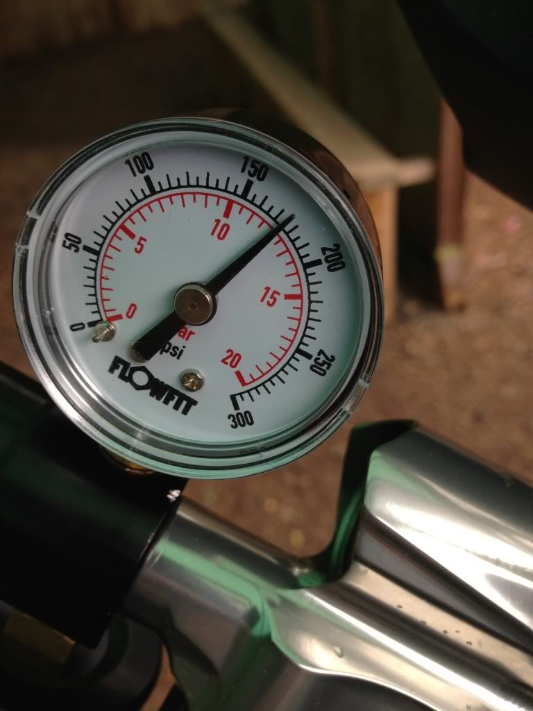

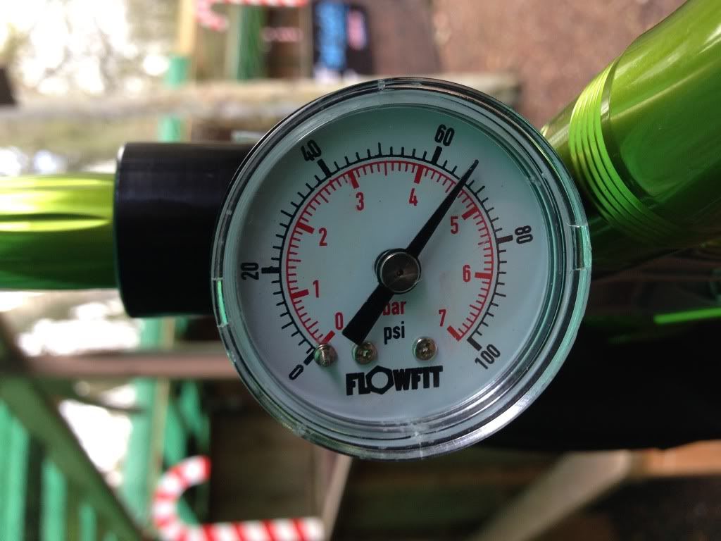

As you know, it is a Texas Storm 2011 G6R and I managed to sweet spot it at:
HPR - 175psi
LPR - 66psi
Poppit Type - LP Poppit
BOLT Type - Pillow
Dwell - 8ms
FPS - 275 +/-3
(Field limit is 280fps)
I was getting 4 x 140 pods per 1,000psi. I still don't think it is tuned right as I had to tune it a bit, take reg tester off (barrel won't fit on when reg tester is connected). But it was near enough.
The original BL Cert shows settings as HPR = 190, LPR=75 @285fps. Since then, it has had an LP Poppit installed.
