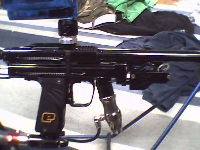

ok guys just got hold of an sto autococker in a trade
its e-griped with a zero-b board
has eclipse front block with eclipse qevs
and a delrin bolt and black magic reg
what id like to know is what year is it?
any tips on timing/maintenance
an aproximate value
and anything else that you might think is helpful
il put pics up later
cheers

whats the serial number?
vertical feeds were standard from about 02 i think but some STO's from about 98 came with them, can tell from the bolt length

Maintenance is pretty easy, a few drops of oil into the ASA every couple of thousand balls and then fire half a dozen shots of air through it. Check the screws are tight and lube the bolt orings.
Timing is easy just set it to the factory fast setting.
Main thing is don't fiddle with it, resist the temptation to mess with the regs or play with the timing settings on the zero B. Belsales and Eclipse both say just stick them on factory fast and leave it.
Knowing the year isn't going to help you much as that will just tell you what body it is.
