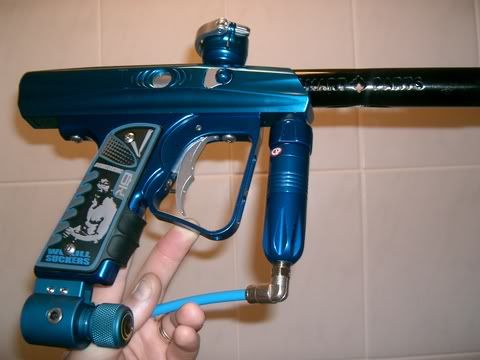

You can get all teh parts you need from various places.
The most expensive are, the Body, which will have to be bought new, and not in this country...i got mine from the states.
The Solenoid/top board...not cheap...not really worth getting secondhand...about £70-80.
A bottom board....Nerve boards can be got cheap where people have upgraded, or you can go for a Virtue or similar.
The rest of it can be bought as aftermarket parts, Ton Ton frame etc...NDZ Bolt...and so on...
Thats teh one I built...but I was fortunate enough to
a) have got a great deal on some secondhand parts
b) in a position to get other parts more cheaply.
Body was $99...which with the duty blah etc...was around £70.
So your looking at around £200 before you even think about all teh other important bits...Eyes are ridiculously expenisive over here.
You may be better off buying a basic gun...maybe a bit scratched, and doing it up.
