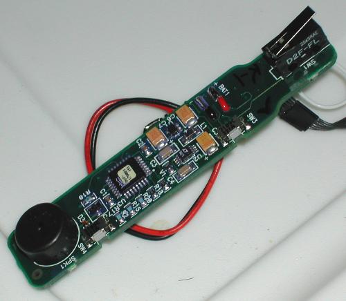

Under my fairly limited paintball knowledge I believe this to be due to the board not having abs? (anti-bolt stick) Am I right in believing that this board doesn't have this? Would upgrading to a virtue board or blackheart solve this problem as I read they have settings to help eliminate this. Only hesitation I have about this is my markers fairly particular as it is one of a kind and has a few things slightly different from most shockers of the same sort so I didn't want to change the board if my one was already custom for my marker (one thing that leads me to presume this is because it chirps which i didn't think most stock shocker boards did).

Hybrid NXT's comes with the stock Nerve board. Some retailers sold NXT's with the Blackheart board already upgraded.
Nerve board
http://www.zdspb.com/media/skr03/frame_lowerboard_vision.JPG
The only adjustable settings on the Nerve NXT board are dwell, recharge, firing mode, and eye sense.
Blackheart Board
http://www.zdspb.com/media/skr03/frame_lowerboard_bh.JPG
Adjustable settings
Solid yellow - dwell
Solid red - recharge
Single blink yellow - Firing mode
Single blink red - Debounce
Double blink yellow - ABS dwell
Double blink red - Ramp activation speed
Fast blink yellow - Ramp sustaining speed
Fast blink red - Ramp activation shot count
Long blink yellow - Eye sense

My money is on stock board. That I know of other than team boards there is only one totally customn board, I know where it is, I know who's it is and I guarantee it hasn't had full code put on it yet.
Anyway, technically the problem is solenoid related, or bolt, or anywhere else air flows for that matter, as J@mes said it's an issue with spool valve guns, the easiest fix is to upgrade the board, Blackheart, Tadao, Predator, Virtue, Hyperdrive, NOX Unleashed(not sure if it has BB eye compatability), APE Rampage, etc etc, only thing I reccomend is leave the blackheart out of your gat.
I've had use of all the boards I've just listed apart from te NOX (very hard to get over here) and the Hyperdrive (it should be in the post as we speak :D:D), who ever you ask will depend whta they have oin their gats, I know people who swear by virtue, people who swear by tadao, and so on.I've only ever had complaints about the blackheart though.
