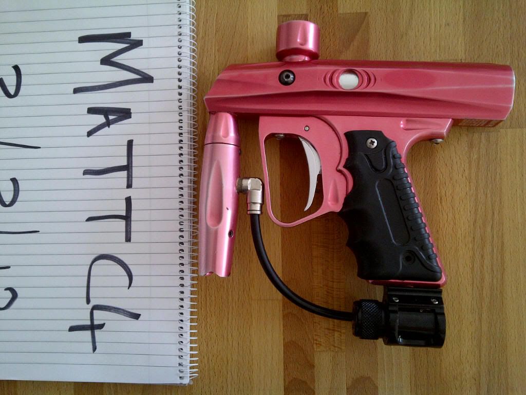

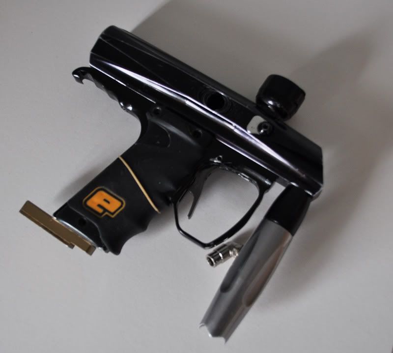

So I picked up this shocker for 30 quid on here as it had a bust noid, I happened to have a spare so was going to fix it and then flip it. But then I decided that as I'm looking to ball again after graduation (so in like 2-3 months) I'd fulfil a long time ambition and turn it into a shego.Renie was kind enough to donate a beat up 05 frame for the cause.
I then ended up trading it with a baller who wanted it for their daughter and offered me a load of shocker/ego parts (more than I'd be using from the shocker) so traded it for this stuff. (I have pm'd renie offering to ship back his frame as I wont be using it)
As you can see alot of the work has been done, the frame has been milled/dremeled out so the noid fits and mounting holes drilled but there are no electronics. Picked up an 05 virtue ego board up for 25 dollars from punisherspb so will be using that.

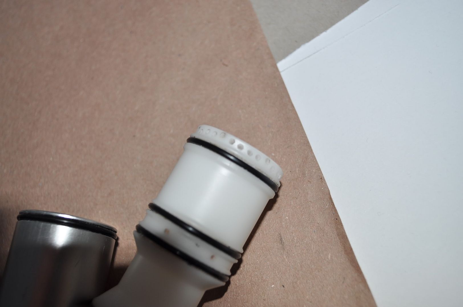

I am doing the Sleeve high flow mod, basically drilling a load of extra holes in the bolt sleeve, about 40% done. Speeds up the venting and pressurisation of in front of the bolt, helping lower dwell and/or operating pressure

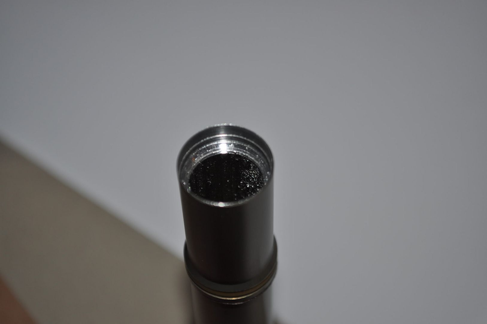

I have cut the bolt guide in half, I'll then be drilling and tapping each half and fitting a grub screw, effectively resulting in a diy NDZ adjustable bolt guide.

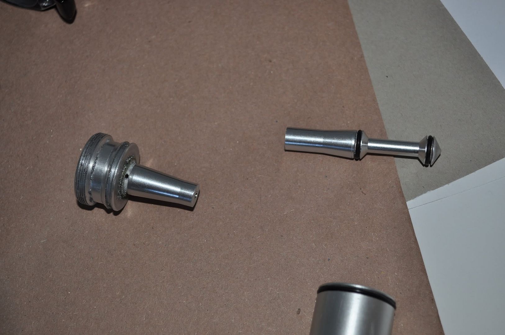

And I have machined out the bolt on the lathe at uni, for the spring bolt mod.
