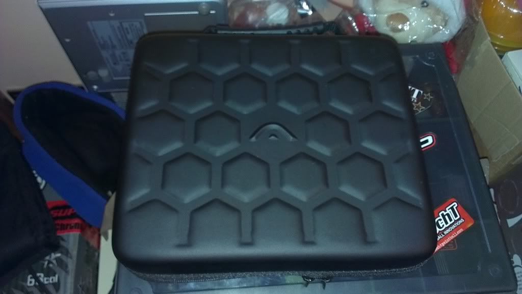

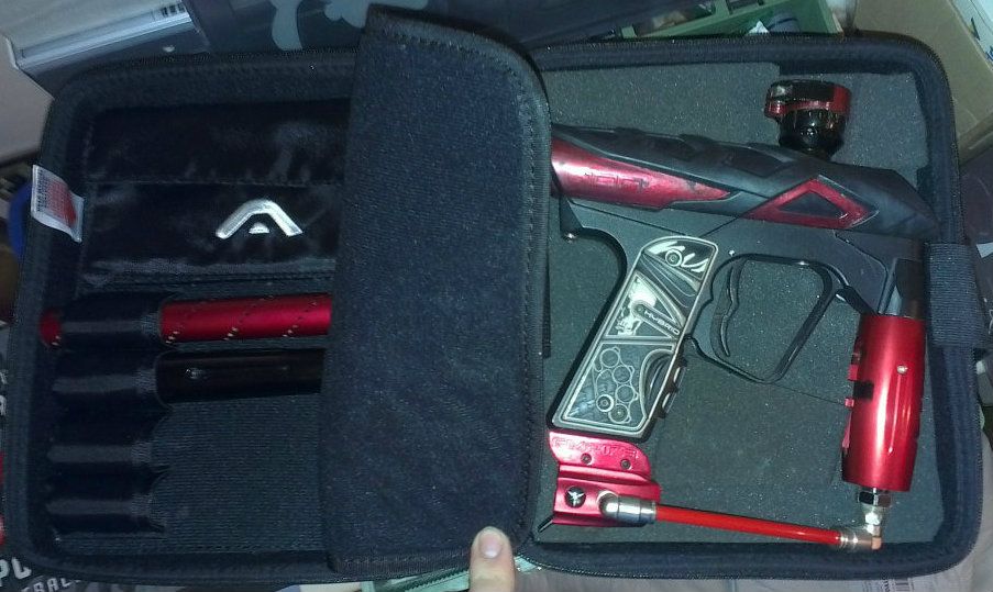

was able to get my hands on a few angel a1 marker cases as i wanted to modify them for the markers ive got and they with abit of work hold the marker better then the cases made for that marker

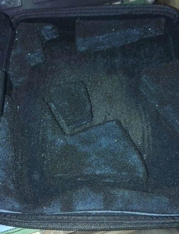

this case
first i ripped out the felt covered insert and worked out which way to mount the marker inside of it

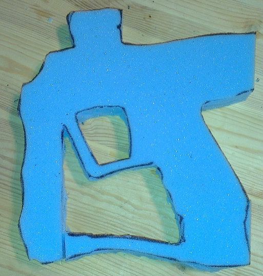

I went to dunhlm mill( like hobby craft ) and got a sheet of foam which was £6 it was about 3 foot by 1.5 foot inly do it in blue so i got some fabric paint in back(£3)
i cut a rectangle the size of the case out it inside then placed my marker ontop then using a sharpie traced round it tight then using a Stanley blade and good set of scissors cut it out like this
then using the glue that you use to stick guttering pipe together stuck the off cuts into the case like this

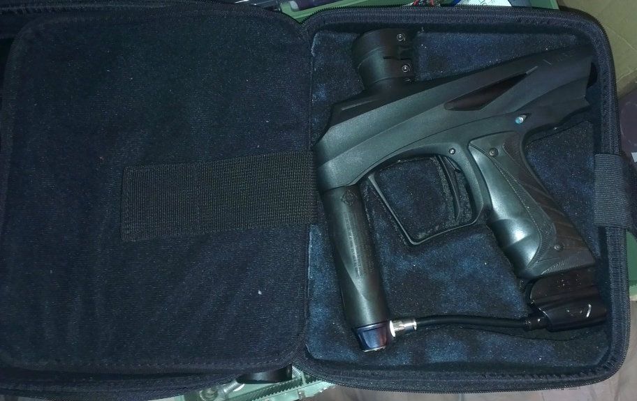

so with the marker in it looks like
just need a ul barrel back to go with it now
my other halfs ion fits in like this
