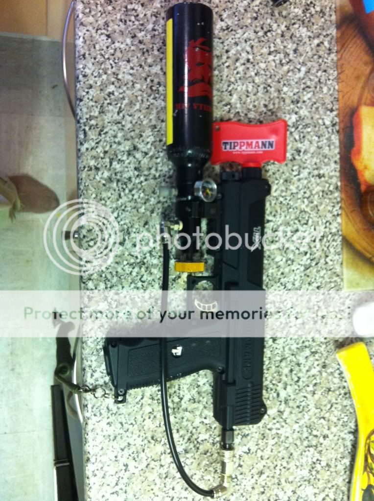

I have also rigged a mini remote line using macro line to an asa mounted to the rail below the barrel. On this I mount a 13 ci cylinder, this is misbalanced and front heavy but frees the pistol from a remote line

When i have the 13ci cylinder mounted its not holsterable so I either use a bag, my trouser pocket or keep it in my hand
