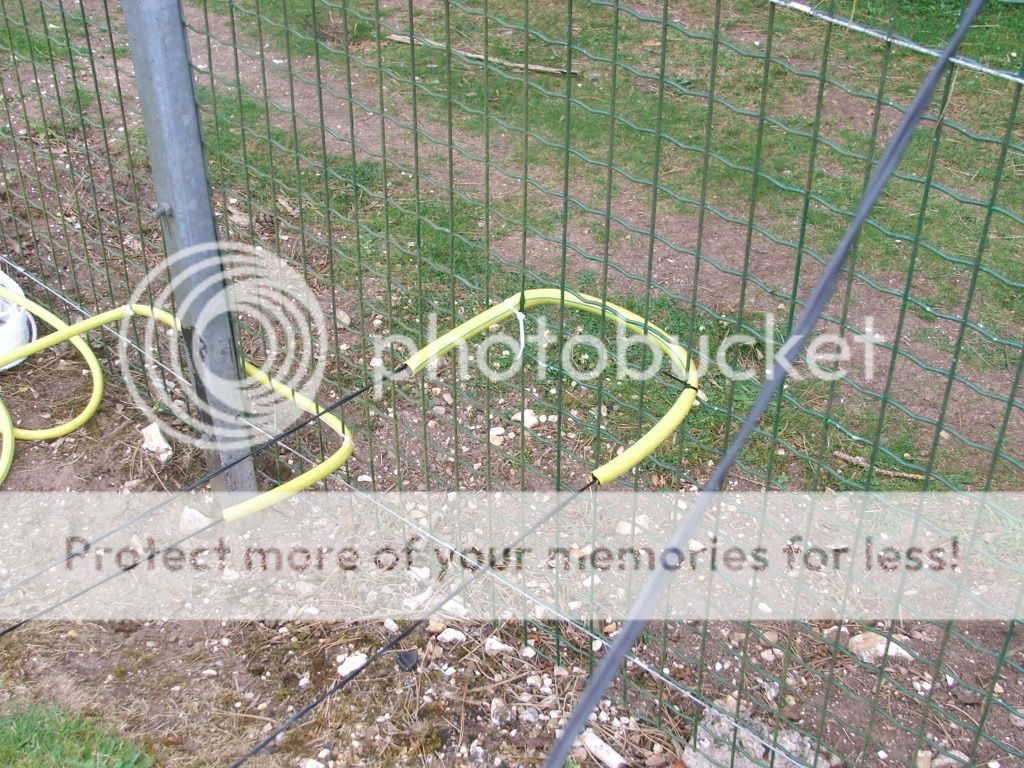

bring it round the solid location - but feed it through tubing to reduce resistance

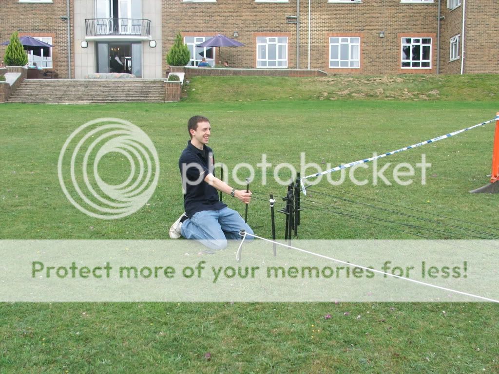

direct it back to an area alongside the firing point, and finish it with a pull handle

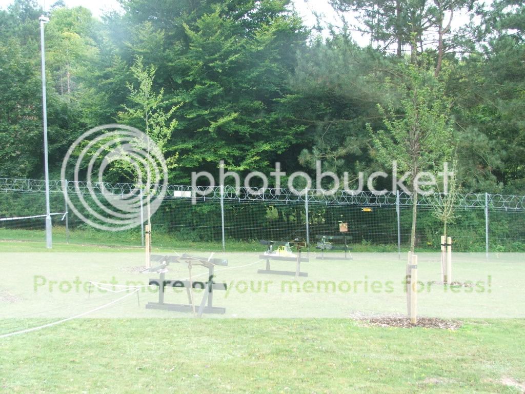

If you have a number of frames you can have high value targets behind low value targets, especialy if you opt for the first design.

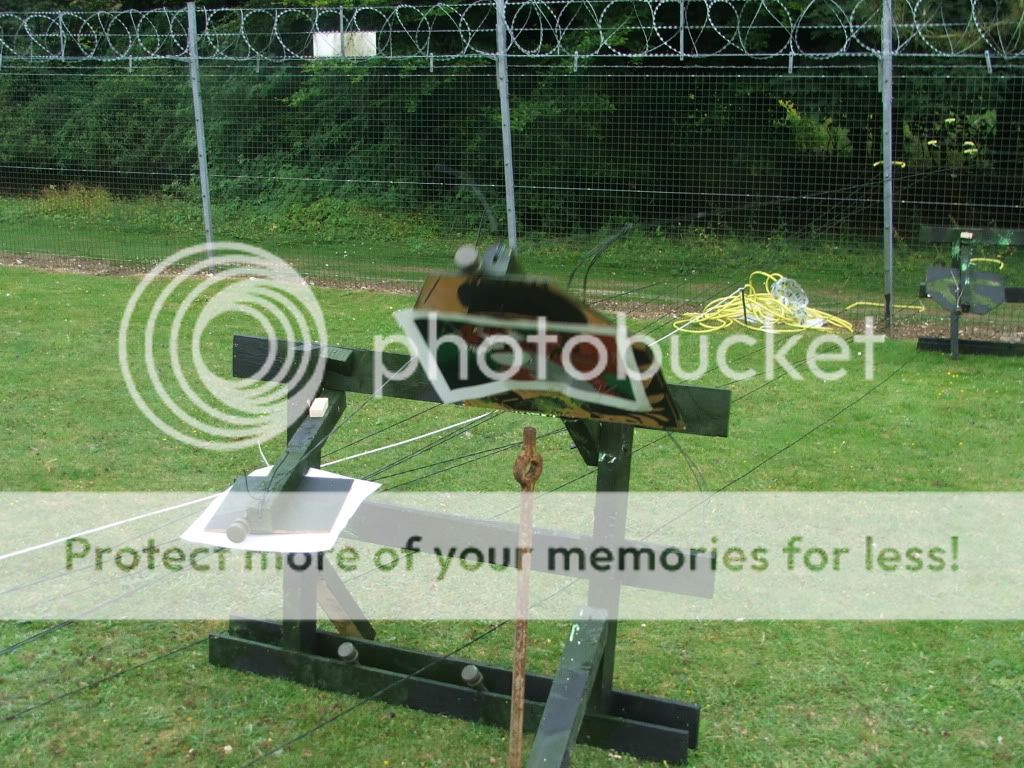

Targets on a frame:
Note the extra spikes

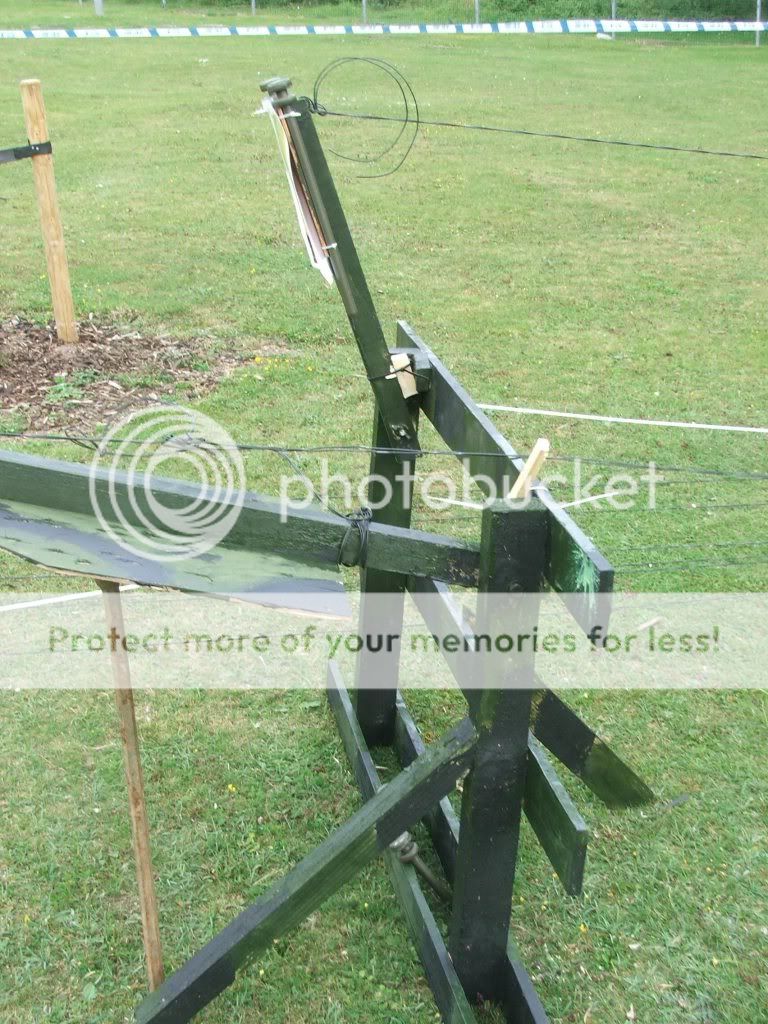

Targets on a frame close up:
Note these were each bolted to one piece of wood on the side, this meant they required big solid bolts with a few washers, some lube, and tight nuts. They would work loose and wobble after a while so need checking to tighten. They would have been better with wood on either side which would allow the bolt to be tightened to the frame but loose with washers for the target to swing freely.
You can also see the spikes used to weight the target, and they are zip-tied in place (See safety note below!)
Targets behind each other:

Target operator:
Safety note on weights
We used spikes on each target as a counterweight. The zip-ties were fine when targets were raised and dropped at a reasonable pace for 'contestants'.
At the end of the day when we played about with rapid target changes some of the spikes worked loose in zip-ties, and one went for a flight!
