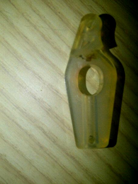

look for the exploded diagram of the cyclone then dis assemble the cyclone and in the botton section beneath the base plate theres the almost oblong ratchet, theres a small noggin onit that the ram pushes against it to turn the cyclone when firing, this noggin had worn on my old A5 so had the same problem cycled fine when empty but was random weather it would turn or not when having paint in it,
cheap part to get hold of think Rap4uk do it for £1.95, or could get a basic tippman parts/spares/service kit form most online pball shops.

give it a good clean out plus its the small noggin that sits withing the teeth of the central shaft that can cause the problem, watch it while you press the manual feed lever and you'll see it move normally, place your finger in the cyclone paddles and if you gently push the manual feed you'lll see how easily it will slip i'll try n dig a photo of my old one out

not the best pic but you can see the noggin on mine has worn quite badly dont knot if this is same issue you having but might be, or the (im guessing) e-grip youve got the internals are dirty???
