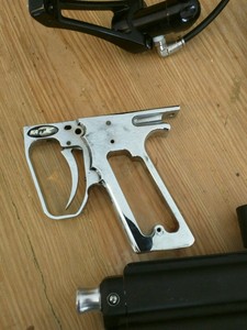

I seem to vaguely remember that back in the day of mechanical semi dominance of cockers versus automags, a common modification was cutting away the single trigger guard and fitting a double trigger.
I think that various events/tournament organisers banned such modifications.
Was this correct, and if it was, is such a modification still likely to land me in the sin bin if I was to attend an event with a marker fitted/machined with just such a modification...?

Correct and correct but no idea about current rules and regs...

It was all about safety as a guard would help stop accidentally pressing the trigger. Applying the rule of common sense I would say its still banned.

There were plenty of double trigger frames made though. May be able to get one cheap on ebay.

Wpbo current rules (6.2.3):
The marker must have a trigger guard that is unaltered from the manufacturers original trigger frame. The trigger guard must protect the trigger of the marker
non wpbo related tournaments, and other events such as walkons, scenarios etc it's up to the organiser
On a safety point of view, I wouldn't be happy with missing trigger guards on events run by me

Could replace it with one like the VM68?
I actually replaced a trigger guard on one of my pumps, which used a cut Autococker frame so it was single a slide trigger again
