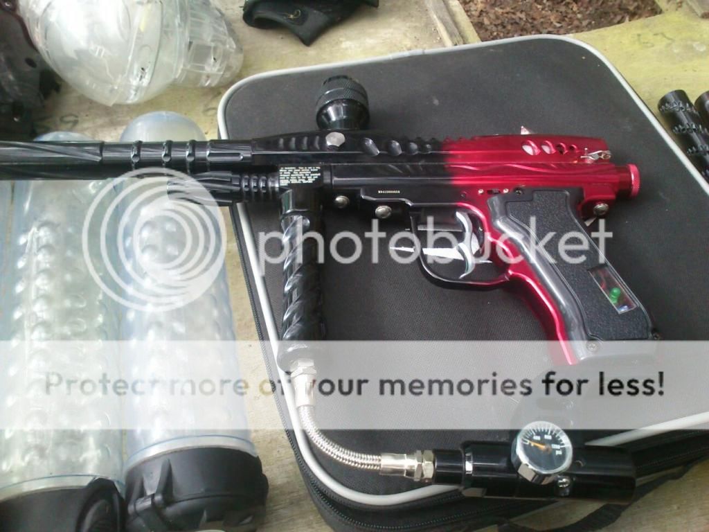

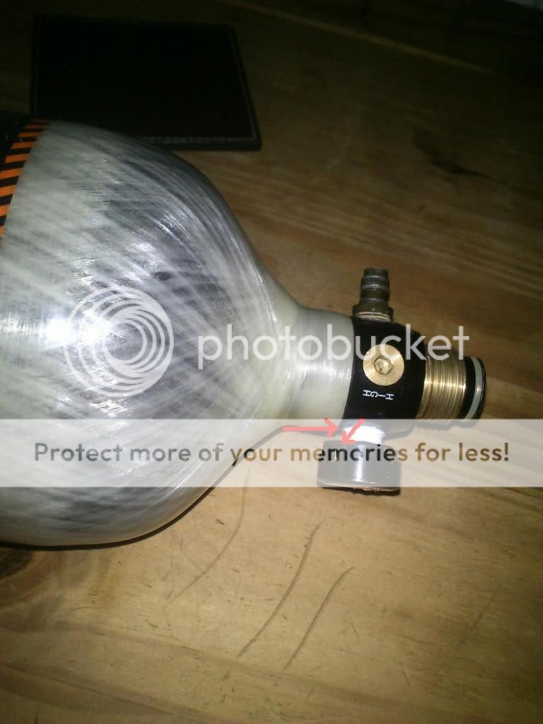

Hey all , hope you are all well , right first of i have an guerrilla air myth g2 regulator and tried to fill it up to day as i have just got it , and yes its on a tank lol , right i have an leak i have pointed out were from it looks like there are two very small holes for something , just hoping some one can help me out thanks , and can some one tell me what marker it is please thanks

Marker Spyder Pilot i believe.
Not sure about the tank though.
Maybe worth contacting the seller or wherever you got it from (Store).
PS The Spyder has been upgraded with custom trigger, drop forward etc.

There's a tiny o ring inside the reg that has gone. Contact RAP4 for a spares kit and they will also send you a link to a video showing you how to fix it.
It's a common fault unfortunately.

thanks for the reply's , i did think that it was the small o-ring as i had a look in it and found that the o-ring and pin thing are scored ! lol and thanks for telling me what marker it is just got it for my dad to play lol
