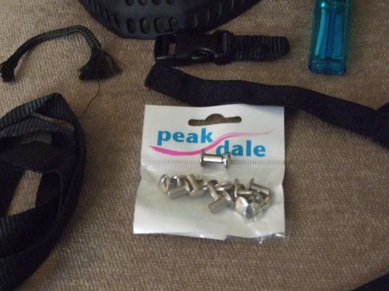

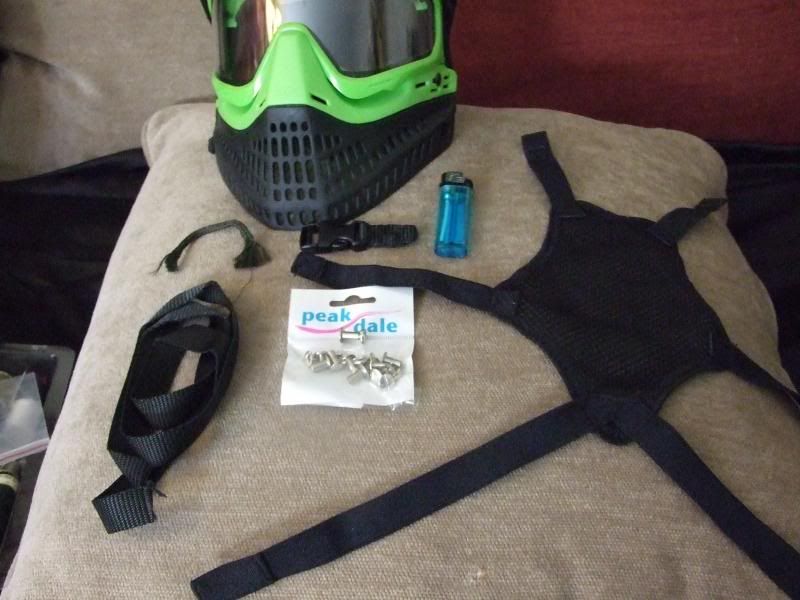

What you will Need!
Mask
Scissors
Paracord
Webbing Strapping
Screw Studs/Binding screws.
Cigarette Lighter/Matches
Needle and Thread.
Gas Mask Harness
2 x clips/buckles.

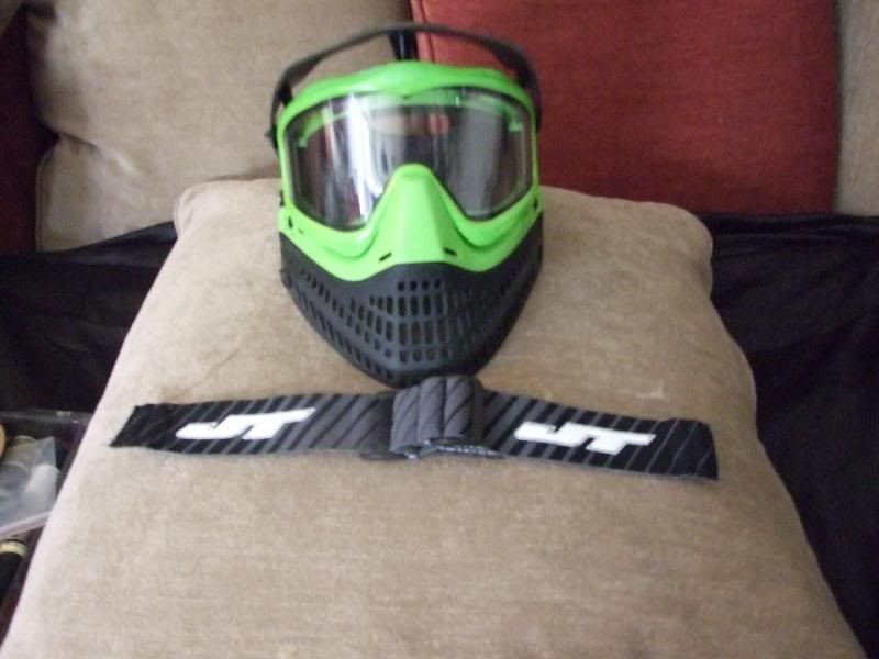

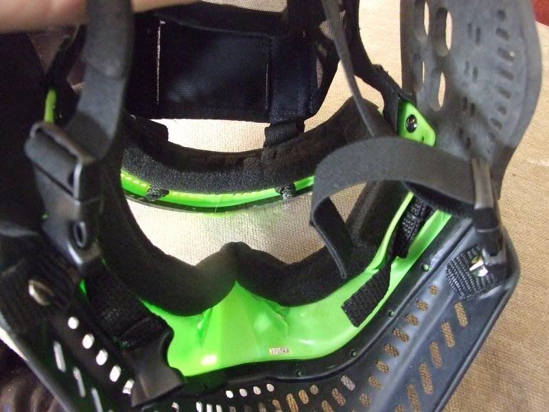

Step 1:-
Remove the Stock Strap from the Mask, and remove the Visor.

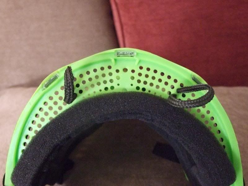

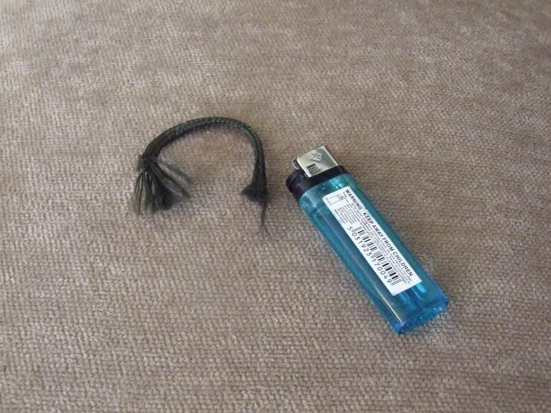

Step 2:-
Cut Short lengths of Paracord, and then using the Lighter/matches, melt the ends into small points that will fit through the Vents on top of the mask.
Push the Paracord through and tie into loops.

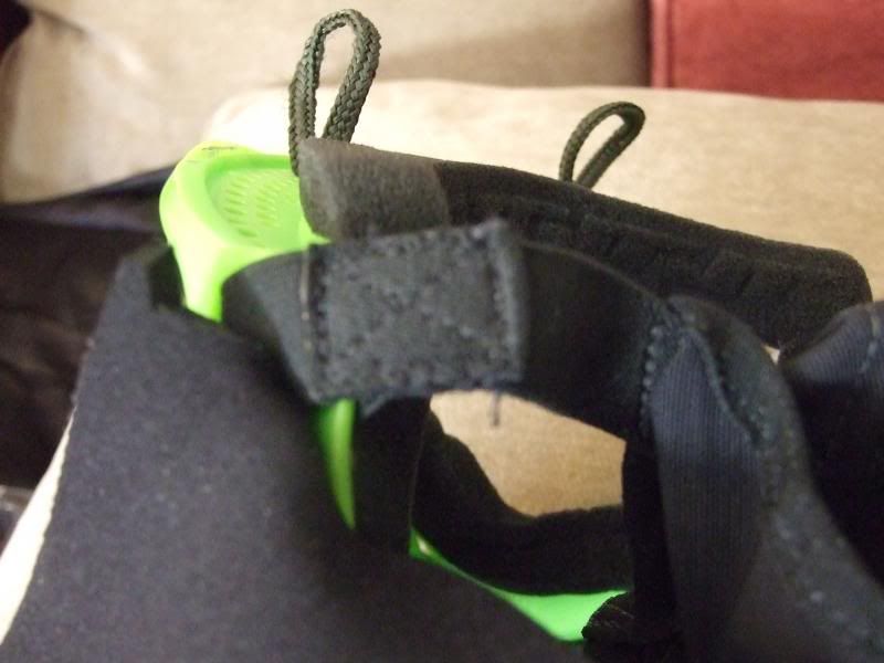

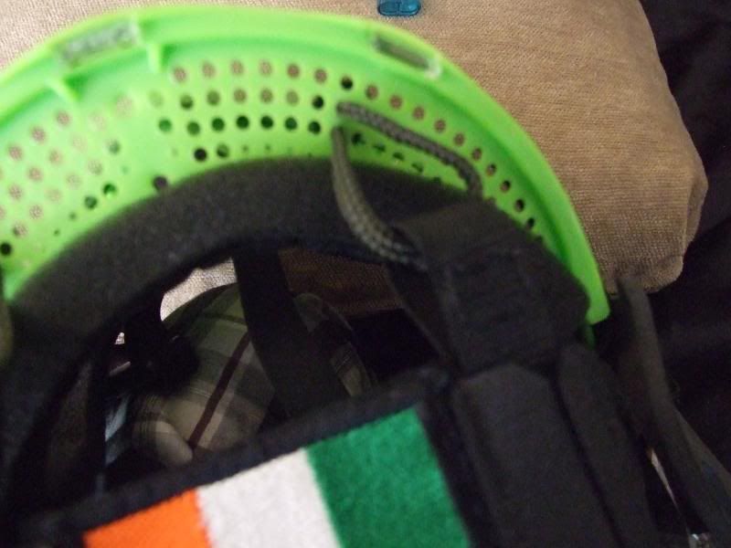

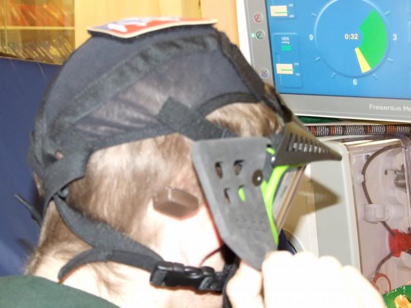

Step 3:-
Feed the top straps of the Harness through the paracord loops, and the side straps through the slit on the mask where the stock strap would be. Stitch these into place.

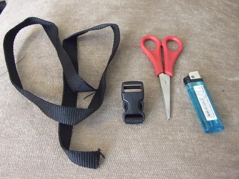

Step 4:-

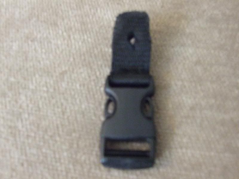

Cut some short lengths of the Webbing strap, and feed through the Female half of the clip.
Once fed through the Clip. Using the lighter, Sear the edges so they "melt" together, preventing fraying
Stitch near to the clip itself to prevent loose movement., Puncture a hole through the straps.

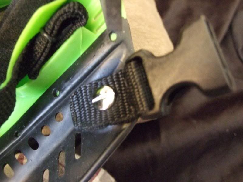

Step 5:-
Take both of your female halves of the clips with the webbing attached, and using the Screw Studs/Chicago Screws,Binding Screws. Fix into place on the lower part of the faceplate (On the JT Flex's there are hole here anyway)
The binding Screws.
put together to give you:-
Step 6:-
Feed the lower Straps of the Harness into the Male halves of the Clips, and then clip them together, and presto your finished.
Just adjust to ensure snug fit.
