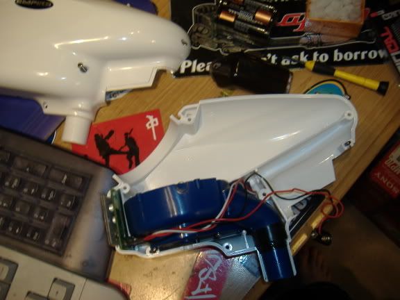

  • Remove your hopper shells.
STEP-2

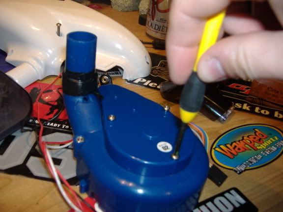

  • Pull your cone assembly out, and remove the 3 screws in the back so you can access the motor.

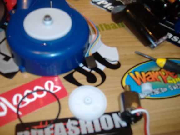

  • You should have the motor, gear and band
STEP-3

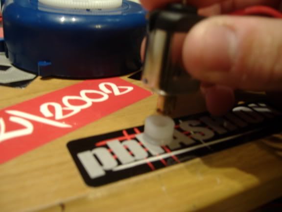

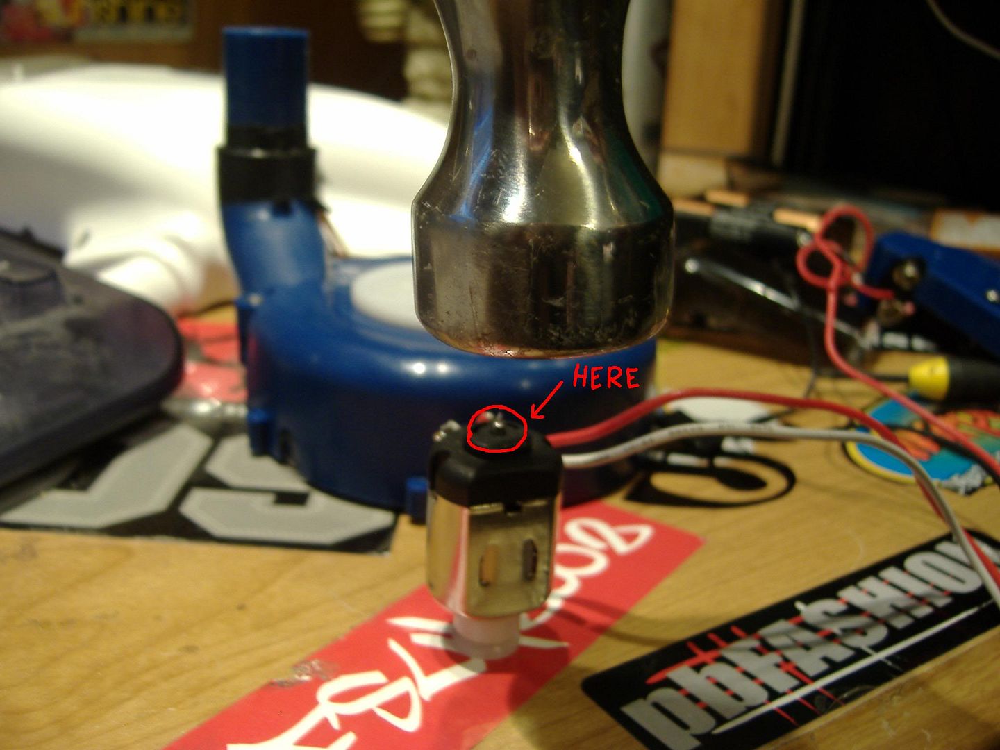

  • Place the speed wheel GROOVE side DOWN on a table, and place the motor over top.
STEP-4
  • Tap the motor where indicated with the hammer, until the brass fitting is all the way in (it should be tight, its meant to be like that so it wont slip)

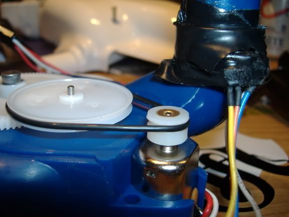

RESULTS:
STEP-5
  • Re-assemble Halo

Will do, and please note that the picture in step 4 shows that you must use a REALLY BIG HAMMER for it to work properly. :D
