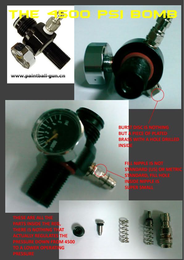

Chen opened the pkg and looked over the reg, everything seemed normal. He then attached it to a 13 CI alum bottle we had lying around. As it was a 4500 psi reg and a 3000psi bottle, he went down to the basement and proceeded to fill it with our 3000 psi scuba tank. He plugs in it, turns on the valve and NOTHING...air does not seem to be going in. He comes back upstairs just as I walked into the office, and he hands it over to me for a closer look.
So I took it apart and the very first thing I noticed was that the nipple wasn't a standard size. It wasn't a US sized fill nipple, nor a slightly smaller one used in Europe. It was some sort of metal that had a shiny surface plating. I then took it downstairs myself and proceeded to fill it, again nothing. I took it back upstairs and took it apart to see what the problem was.
As I broke it down, my jaw dropped. There were so few parts inside, and upon closer inspection, there were absolutely NO safety features on this reg. What is supposedly a burst disc is nothing by a piece of plated brass with a hole drilled through it. Inside of the reg, there was NOTHING that regulated the air pressure down (there's usually a series of discs and valves and "turns" the air, forcing the pressure down). The fill nipple was the same plated metal and the hole that was drilled thru it was very small. The spring valve had no slot drilled into it, so when we tried to fill it, it actually created a perfect seal inside.
The fact that this thing did NOT fill probably saved our lives. Had we achieved in filling the bottle and connected it to a marker, all 3000 psi would go right into the marker, probably blowing up the gun. We could have been seriously hurt or even killed if anything had exploded.

Rosa, I had received the sample you sent me by Fedex. I thank you very much for sending it. Upon inspection of the unit, I’m disappointed to tell you that it does not work. I had your regulator sample taken apart. Theirs is NOTHING inside that REGULATES the air pressure. I don’t think your company knows anything about safety and manufacturing of products. You can’t have possibly sold this product to anyone before without them telling you about it. With high pressure air, if you’re not careful, a bottle or a gun can explode. Are you trying to get someone killed?

After this email exchange, I took this regulator down to my friend Mr. Sun for a closer inspection. Mr. Sun is one of the most knowledgeable Paintball experts in all of Taiwan, he owns the company that makes the mini invert, and the BT TM7. He also makes air products like regulators, fill stations, etc. He takes the reg apart and looks at it and just shakes his head. He says there's no way in hell that this regulator would work with the parts it had. He also finds it completely bogus that TMT can sell 1000 of these things without anyone getting hurt or dead...
These TMT people obviously do not have any clue how a regulator works, and what kind of danger they put someone in with the garbage they're selling. These people are not selling teddy bears, they're selling a device that is designed to control thousands of pounds of air pressure. Please do NOT support manufacturers like them by buying their products. Everything comes at a price for a reason. I hope to God that they really didn't sell 1000 of these things into Europe. If ANY of you see an online ad selling a cheap reg, stay FAR FAR AWAY!
The following is a quick illustration I made with pictures I took from my cell phone...not the best quality, but you see the actual reg they sent me.
