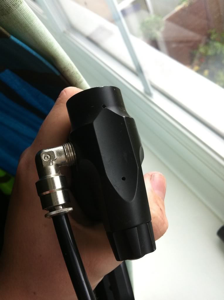

When I put gas in it leaks out the top hole. Can anyone help me on what it is and tell me what I do to stop it. Cheers

check the o ring on your bottle mate first thing to go
This /\
Also if that is how far you turn your on/off, I'd give it a quarter turn back out to avoid shootdown. Not sure about the eclipse asa's but some don't like being on all the way. I have a cobra coil remote for example and if I tighten the on/off all the way, the valve pin pushes down so far on the tank pin that it kind of seals itself and makes for a very restricted airflow.

sorry mate i dont get what you mean ? your asa cap should always be screwed all the way in ? if you are at CC next week then let me know and i will sort it out for you

now its leaking out the bottom hole, or it could just be changing between the two, not to sure. i changed the bottle o ring

if it leaks out of the front hole (nearest on/off knob) then the o rings on the oops pin are dry or damaged, lubricate them or replace if neccesary
if it leaks out of the rear hole (nearest the tank) then the tank o ring is damaged, so replace the tank o ring

was leaking out nearest to tank, now its nearest to on off knob, how do i get into the asa to check the orings? or whats this OOPS pin? cheers guys
