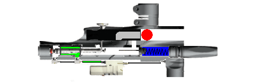

almost got the operation of the gun. there's a really nifty set of diagrams in page 9 of your manual but basically the rammer is held back by pressure at the front of the rammer coming from the solenoid. when you pull your trigger the solenoid vents air and puts air behind the rammer, pushing it forward. when it strikes the poppet the air from the HPR travels up through the bolt. after this when the set time (dwell) has elapsed the solenoid puts air back in front of the rammer and this pushes it back to the starting position. this is often called an air forward/return design, whereas a simpler design may use a spring return
http://www.zdspb.com/media/tech/animations/ego_etek1.gif

Cheers matey that animation is really easy to understand. I did read the book version but to me it wasnt all that clear if i'm honest.
