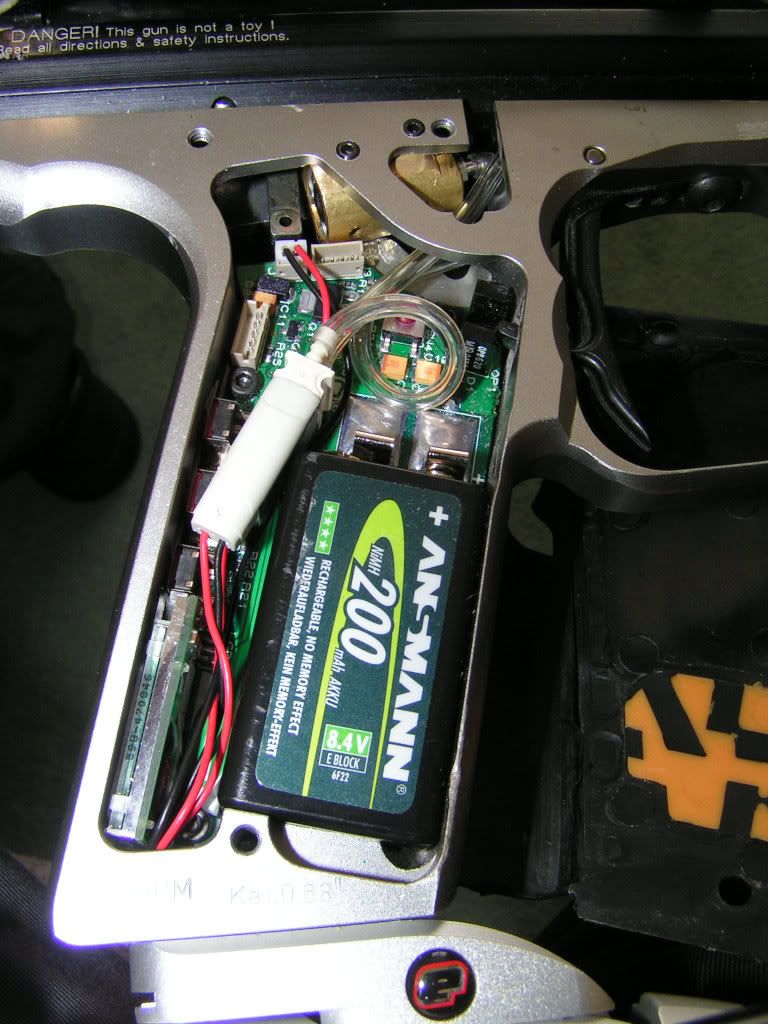

I've been tinkering on an electro conversion for my X-valved mag, that's slowly come together over the last few weeks. It uses an 05 ego frame, minature solenoid & clippard ram from Air Soldier in the USA.

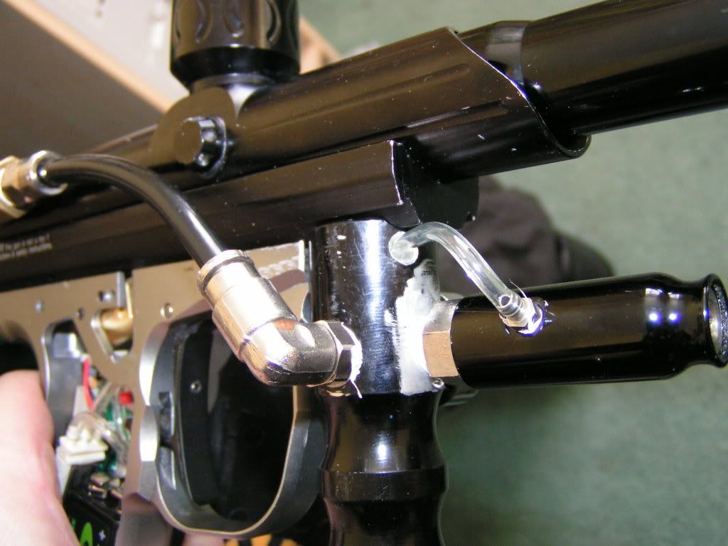

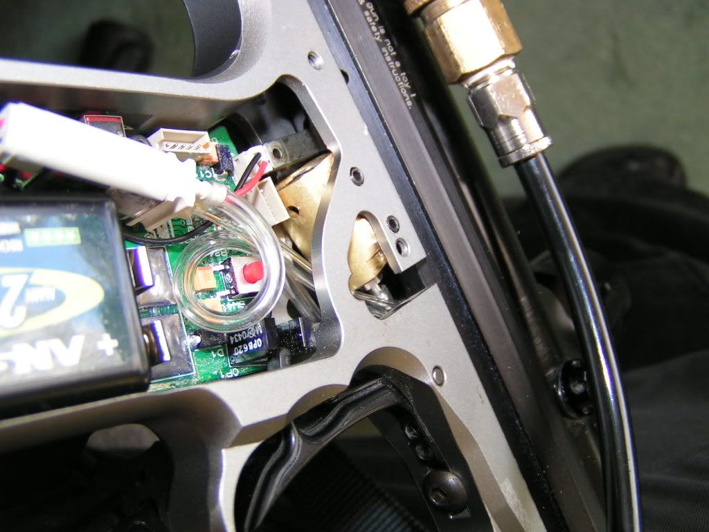

Fitting the grip frame involved a bit of cutting and re-drilling of holes. I had to dremel the top of the frame to get the modified ram in, and secure this with four 6-32 grub screws. The sear is operated by a nylon piston fitted the the ram, which is fed air at around 70psi from the mini LP reg. The lp hose runs through the foregrip and down a channel in the frame to the noid.

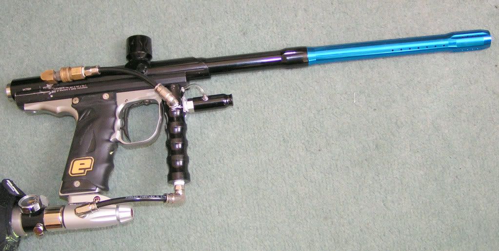

All the bits fitted really neatly in the Ego frame, and I aired it up today for first time. Had 12bps out of it with eyes off (not installed), but you can get 15bps+ without chops with the X-valve as it has LVL10 bolt as standard.
Next stage is to get a bit of milling done on rail, and then ship parts off to Slothball to get it re-annodised. I'm thinking of matching everything to the dust silver Eclips OOPs...?
