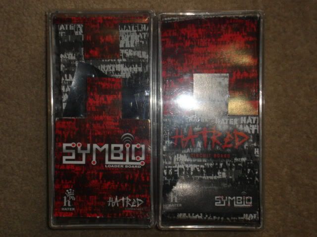

Fire modes on the Hater Board:
(Please note the firing mode order on the back of the HATRED box does not
correspond the actual order.)​
