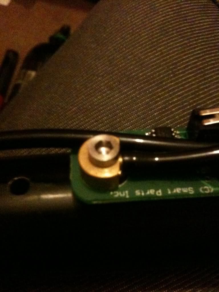

i have removed the composite body and put the board back on and used rubber 9v battery connector covers to space out the banjo fitting fromthe grip frame so the button sits where it would be with the body on.
its alot lighter but its left with a 1/8 inch gap which is what the old composite bodywould have filled up...

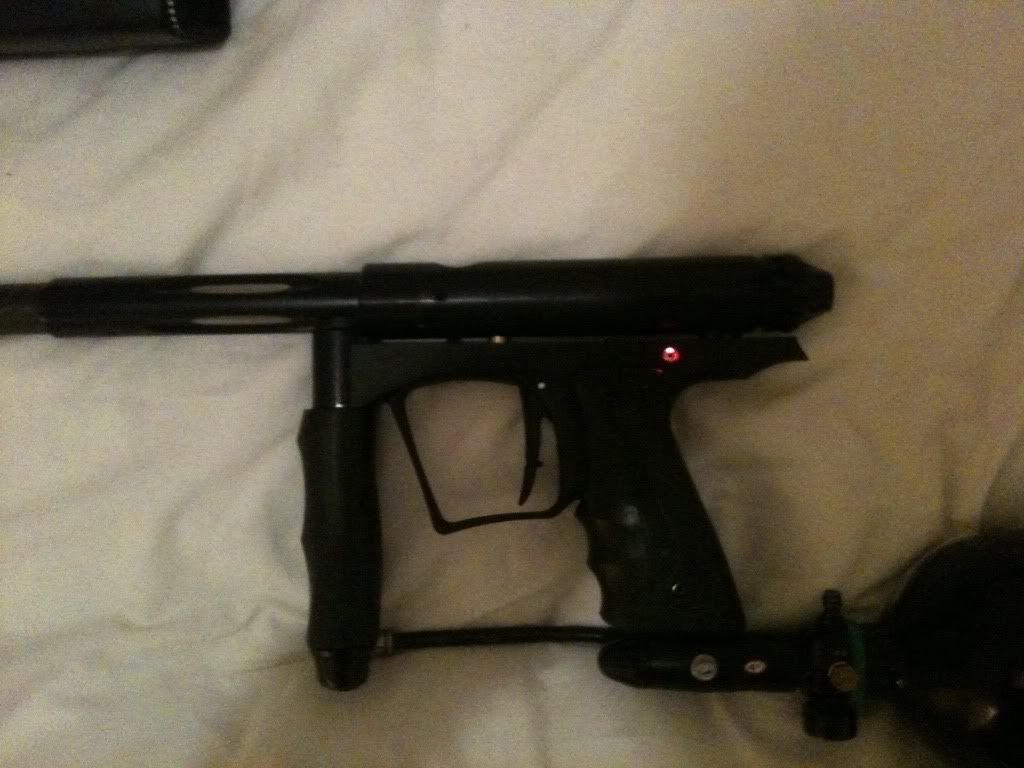

heres some pic for you to look at !
the full picture of what it sort of would look like

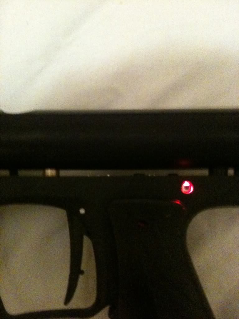

close up of the gap but you can see the button is spot on where it should be

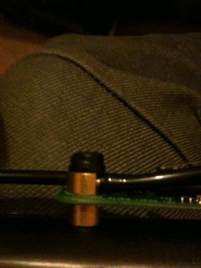

banjo with and without rubber spacer ... obviously this would have to be made of plastic

Er.. hi bud,,, i think all you have done ,, is make a wasps nest full of problems,,,
The weight of the plastic body is what,, may be two or three fags in weight,,,, by the time you have a allloy spacer,, your be back to the same weight,,
if you really want to save weight,,, lose the ASA,, machine rails into the bottom of your trigger frame,, so your trigger frame becomes your ASA,,
use a carbon fiber barrel,,,
all your going to end up with here is a lot of problems,,,
and theres no problem with weight is a gun or marker has a perfect balance,, in fact balance is more important than weight,,,
if i was you.. i would just refit the plastic body and go play,, before you end up with paint all over the board,,
But adding a sideways look,,,, to make a alloy rail/block to do what you want by hand on a mill and lathe is not going to be cheap...in my day job i charge up to 200 pound a hour for hand machine work,,
now as most of you know,, i dont charge that for paintball stuff,,, but im just letting you know what your getting into,,
and we have not even got to the billit block of alloy your going to need to buy to make all the parts out of yet,,
how ever,, we could machine away half of the plastic body that it came with,,, to get the same results,,
and it would be lighter than using metal,,,

i can make any thing fit any thing bud,, no worries,, but can you pay for the work,, to mill all that excess metal off will take some time,
but the alloy will be more heavy than the plastic,, and you started with,, want to make lighter,,
I have just got my hands on some vibe stuff,, and in with that was a body kit,,,, now also remeber if you expose the detents,, every time you fire they will just fall out of the side of the breach,,as the plastic body is what hold the detents in place,, also ,, the vibe breach has no thread for the feed neck,, the thread is in the body,,
as for DEADLY WIND,,< i just love that name > yes there bodys are 40 dollers,, then shipping then import tax,,, your be looking at 60 to 70 quid by the time it hits the uk,,
i do have bodys here some where,,if you want one i will have a look see as to what i have,, but there nice bodys,, seems a shame to remove all the body work,< milling >, to just have a spacer and a feed neck holder when you all ready have that on your standard body?
you need to take a step back and have a long hard think about what you want,,as once its done theres no going back,,,, well there is,,if you want..
