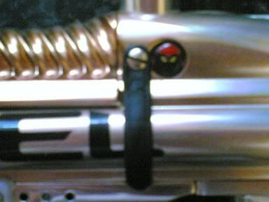

ok i have a dark series ir3 angel, its got eyes but i had yellow paint and it wouldn't fire sometimes then wen turned eyes off it was fine anyone know why?
Its not to do with the colour of the paint if its breakbeamed.
There are several factors that can make a difference however.
On an angel(and many other guns) the ball can be allowed to roll backwards in the breach.
Small paint or a bad ram position can aggrevate this effect to the point where the ball has rolled too far back to be picked up by the eyes.
Similarly bad ball detents can allow the ball to roll forward, causing the same problem.
To prevent this problem from happening on spitfire guns we put alot of effort into finding an eye position that works with even the smallest paint with a badly set ram. So our customers wont get that problem.
If you dont already have a softnose bolt then get one. Otherwise just use large paint.
If it was summer I would also take a guess that light may be shining into the gun somehow and messing with the eye signals. But I doubt sunlight is your problem.
Right well make sure that your ram position is set correctly (according to the angel manual) and your ball detents are working as they should.
The only other thing I can suggest then is to avoid shooting small or misshapen balls.
Maybe you can consult whoever milled your eyes / did your install for more guidance.

a pic from the outside. Make sure you take it with the gun flat and on it's side, so i can get an idea of the position as accurately as possible.
