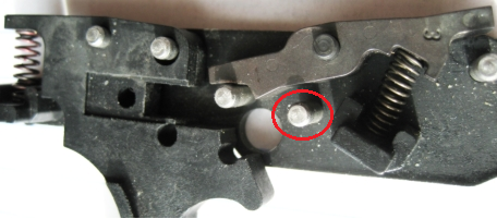

Oh aye, i took my grip to pieces and the trigger mechanism, found that there was a pin missing (circled in pic)
could be a problem as it supports the armeture. not been able to test it yet.
Cheers
