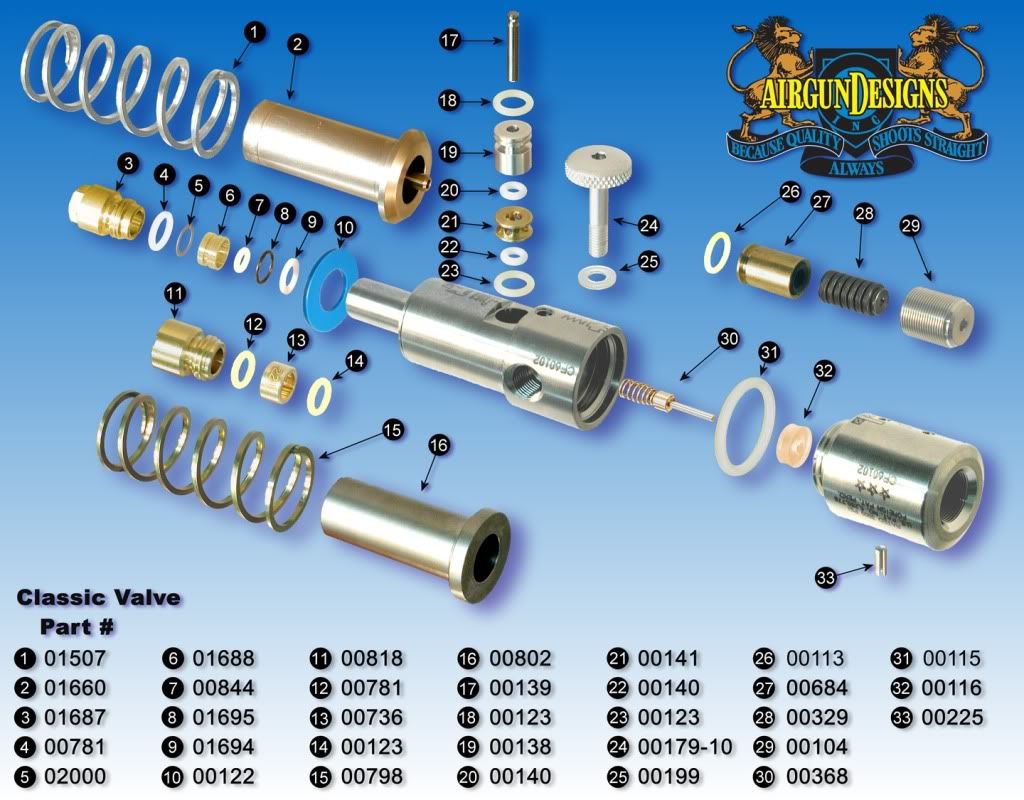

Hi all,
I am looking for some Automag parts.. The screw for the velocity adjustment (inside one). As my mag is blowing from the adjustment screw. And it looks like that screw is damaged. Also I'd like an oring kit if price is right :)

It's more likely the original on your spring pack mate the adjustment screw is just a screw
When I stripped the marker down I noticed the threads were damaged? Which one is the spring pack? (new to stripping down a mag)

its more than likely o-ring number 26 that needs replacing I cant remember the exact size but il try and look it up for you
but try removing it all 1st and giving a nice bit of lube 1st

Brilliant thanks for the exploded diagram, going to be very useful :) it's the thread on 28 that is damaged.

28 is the spring pack, 27 has a burst disk but they very rarely go, its 99% the oring that's the issue

leaking out the velocity adjuster is usually a duff o-ring on the piston (26) or faulty regulator seal (32) - So try swapping them and see if it fixes the problem.
If the threads on adjuster are shot it's possible the threads in valve are bad as well, which will mean regulator body needs replacing
